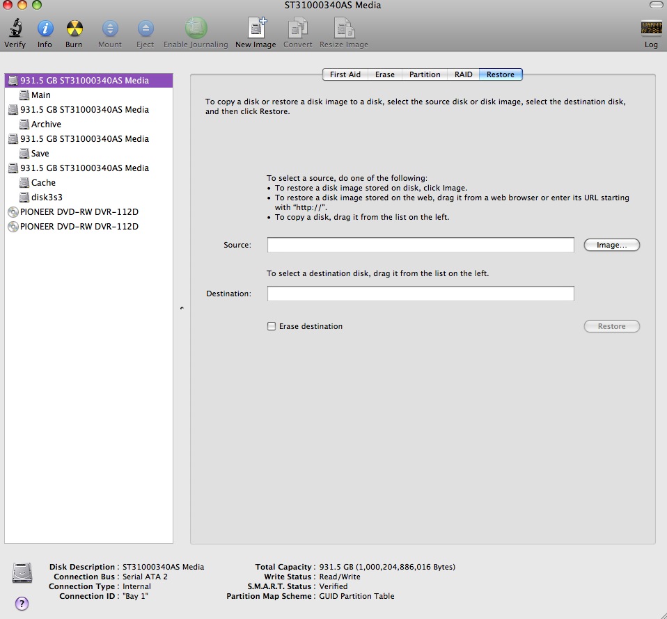

10.5.4 has just been released. As many probably know, each time an update is released many complain of bugs and failures that they cannot recover from after the update. In most instances especially when updating Quicktime versions the only solution is to wipe your OS drive and reinstall everything, a task that for most would take an entire day when you include updates to current versions.
There is however a simple, built-in OSX feature that allows you to save your entire OS - apps and all - to a safe location for future restoration in case the update/s causes things go south. And the best part: It's free and requires nothing except your time, no additional software is used.
NOTE: The steps below should be used *anytime* you update anything mission-critical such as the OS, Quicktime, FCP components and plug-ins and any other app that you need to perform your work. This process saves the entire drive/OS and apps as an image so everything from system prefs to emails to any saved files on the main/OS drive is included.
Here's the step-by-step process:
1. Boot from the Apple OS disk that came with your computer or, a retail copy of OSX (preferably the same version as the OS you're about to save). When the setup routine starts go into the menu up top for "Disk Utility".

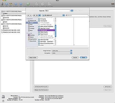

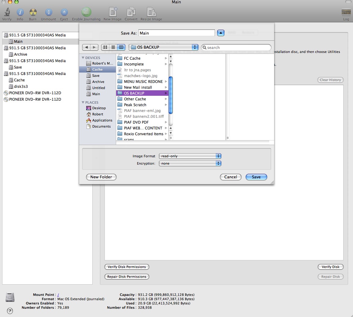

2. Highlight your OS drive and then select "New Image" from the D.U. menu above. This will bring up a screen where your OS image will be saved.
3. The name of the drive will automatically be created in the "Save As" menu up top; point this new image to either a second internal drive or an external in which you can create a folder that says "OS Backup" or whatever naming makes sense for you to find it in the future.
4. In the lower sub-menu select "read-only" and "none" for encryption, then hit the "Save" button. Depending on the data-size of your OS drive and the speed of your computer it will take anywhere from 10 minutes to up to a few hours to create a new cloned image of your OS drive. NOTE: The data-size of the new image will be the exact size of the total data on the OS drive, NOT the physical size of the HDD itself, in other words you're only making an image of the data, not the entire drive with it's empty unused space.

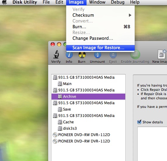

5. After the image has been created then goto the "Scan Image for Restore"; this will verify the copy you just made is data-perfect and ready to be used for restoring your old OS.
Now that your OS drive has been imaged it's now "safe" to install the updates to your current OS and see how things go. If indeed they go south and you need to fully restore your system from where it was before the update follow these steps:

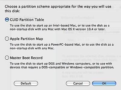

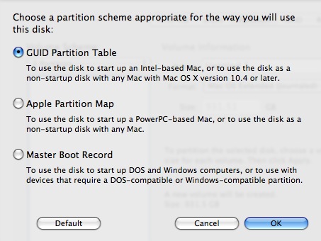

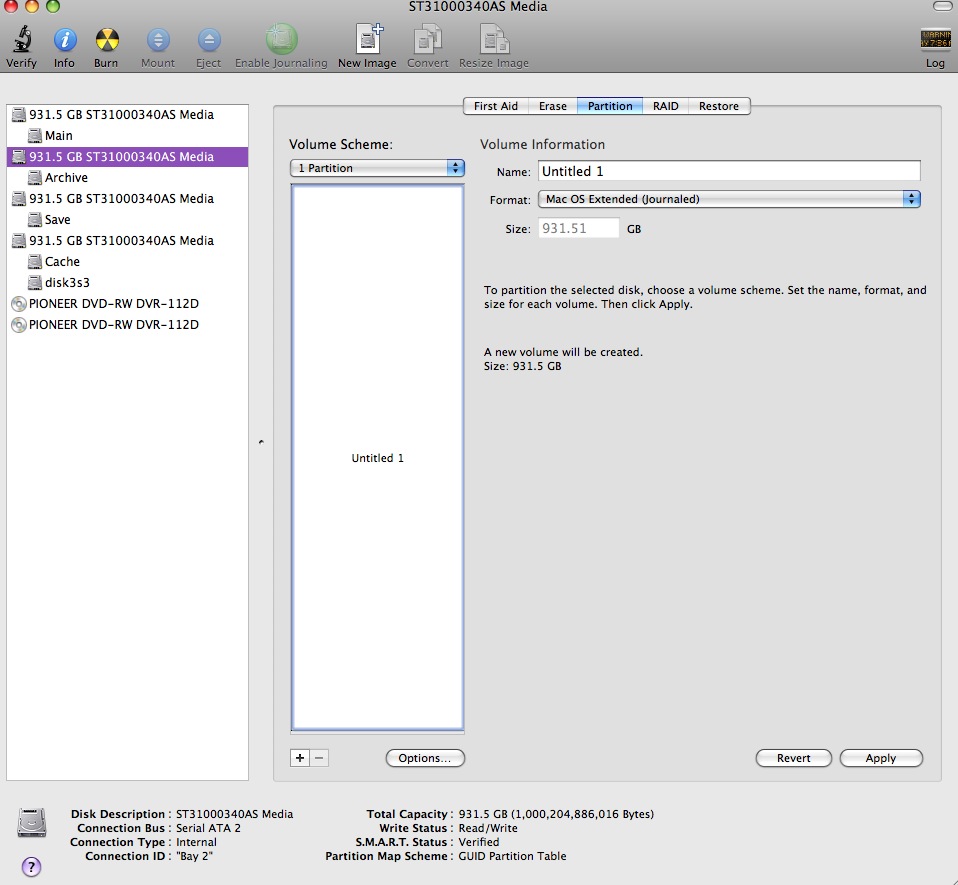

1. Boot again from the same OSX install disk and enter Disk Utility. Manually re-partition your OS drive to the same specs as it was previously. MAKE SURE you do not change the format type (Apple Partition Map vs. GUID) from what it was before you imaged it. This also applies to Journaling; if the previous OS image was Journaled, then match that setting.
2. Now that the OS drive has been reformatted go to "Restore" in the menu, select the previous OS image you created before as the "Source". Select the now reformatted drive as the Destination. NOTE: Remember to name the Destination the *exact name* as the original OS image otherwise things like FCP will lose connections with external data sources such as renders, cache files etc. You do *not* need to hit the "Erase Destination" button since you have already formatted it manually.
3. In about the same time it took to create your backup image Disk Utility will re-copy this image back to your OS drive. Once it's finished you can then boot from your OS drive as normal and voila - you're back to where you started before the updates.
If you want to be extra-safe with your mission-critical system you should do this OS backup routine at least once every 2 weeks just as extra insurance against a complete drive failure. This way you'll always have a copy of your OS drive on-hand ready to be restored in case the worst-case scenario happens. It's insurance, and it's no cash out of pocket, just your time.
