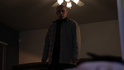

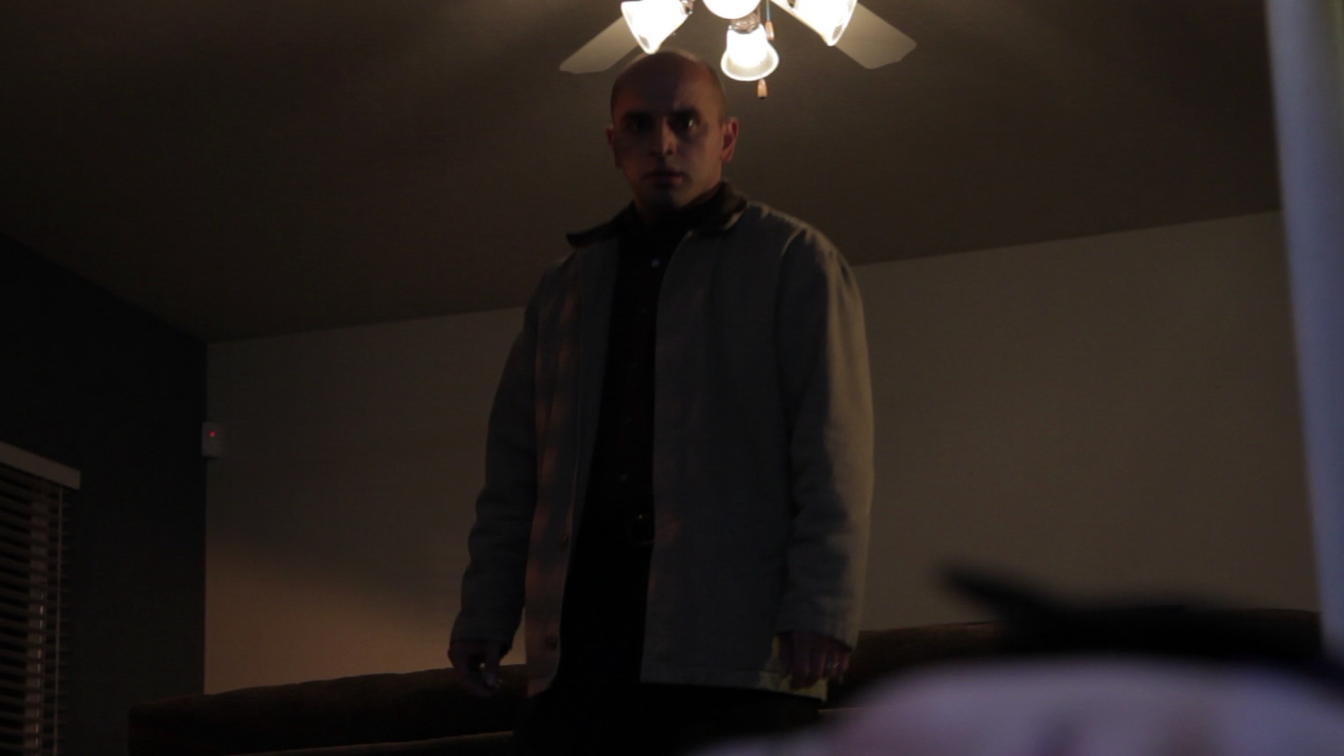

Well, that's the upside.
Basically, here's the deal: I have a darkened room. On one wall, I did a "lighting gag" that is supposed to be ambient night spill coming in through a window. Only looking at this footage later did I realize I shaped my pattern incorrectly. I need to add some darkness that matches the dark wall, to cover/replace where some of the light hits. This is what I mean by shadow. Wall in question is flat.
It's a totally static shot for a while, then a character walks up to the lens, obscuring the problematic wall area. Then the camera pans (we're already not seeing the wall at this point), then we come back to the original composition, more or less.
Some of this depends on how the movie is cut. I highly doubt all of that will be used.
I do have Color, just don't think of it 'cause I have no way to view my results on an external monitor, but for something like this it might be perfect.
If I have to reshape the mask frame by frame, yes it's tedious, but I can deal with it.

can't you create a mask with an infinite number of points in color, and then simply reposition those points frame by frame as needed?
I'm sorry, I should've mentioned this earlier. . .what I'd REALLY like to do is take a copy of the layer of video, crop it to just a dark section of wall, and move that cover where I want to. Kind of like using the rubber stamp tool in photoshop. So I wouldn't be painting a shadow per se, but repurposing a piece of video that already exists.
oh hell. Let me just attach a still.

Now everyone can see what I'm talking about.
