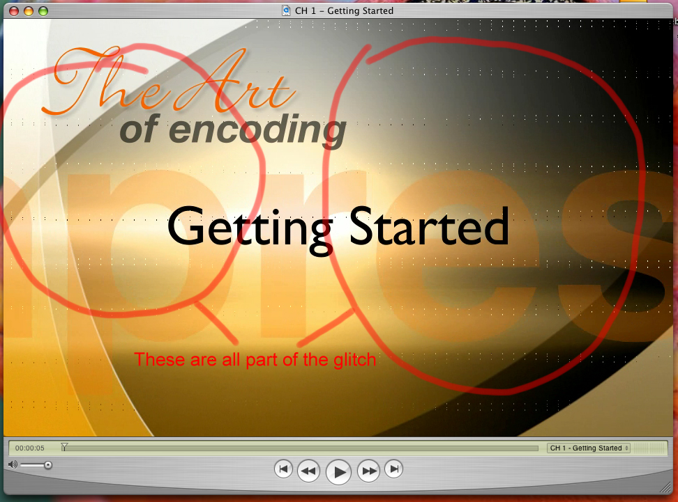

Ever since I installed it, I've been getting these really weird vertical black and white, dotted lines appearing everywhere, ESPECIALLY when I playback a quicktime movie!
This includes my canvas in FCP and Motion. And the worst part is, sometimes when I export a quicktime movie (from Motion) the glitchy lines are IN THE VIDEO! This is unacceptable for me and I need to alleviate the situation asap, as I begin work on a new project very soon.
I've included a picture and a video example:
http://img170.imageshack.us/img170/8...roblem1bn1.jpg
http://img170.imageshack.us/img170/9...roblem2nr0.jpg

Installed Final Cut Studio 2 - Now I have strange vertical lines / glitching! HELP-fcs2.problem1.jpg   Installed Final Cut Studio 2 - Now I have strange vertical lines / glitching! HELP-fcs2.problem2.jpg

Even when my Mac is booting up... the glitchy lines appear. They are everywhere! Not just in FCP , Motion, or any FCS2 app.
I stumbled across another forum somewhere and am starting to suspect incompatibility issues with my Radeon X800 XT & some new video drivers (or something) that was installed with Final Cut Studio 2.
