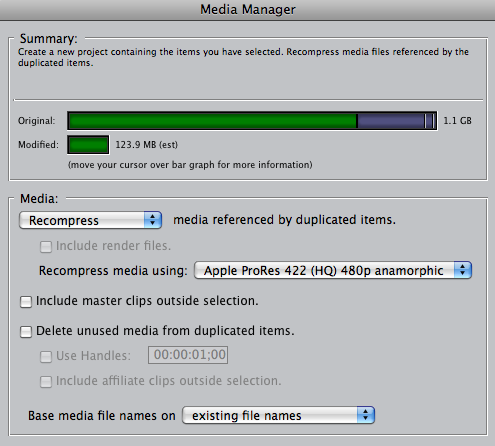

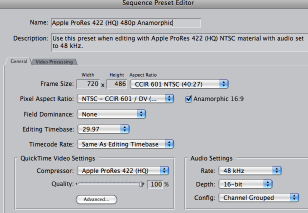

You don't need compressor to do this. You might as well use FCP's Media Manager.
First create a new sequence preset by duplicating the Apple ProRes (HQ) NTSC 48Khz setting and then modify the field dominance to "none" (which is the same as progressive) and checkmark "Anamorphic 16x9." Change the name to something like "Apple ProRes (HQ) 480p Anamorphic." Click OK.
Now select all the 1080p30 clips you have ingested and open Media Manager. Select "recompress" and choose your new Apple ProRes (HQ) 480p Anamorphic setting.
That's it.
When you are ready to edit create a new sequence and use your new sequence preset.
