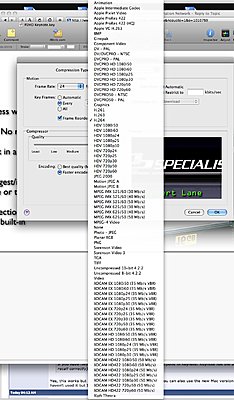

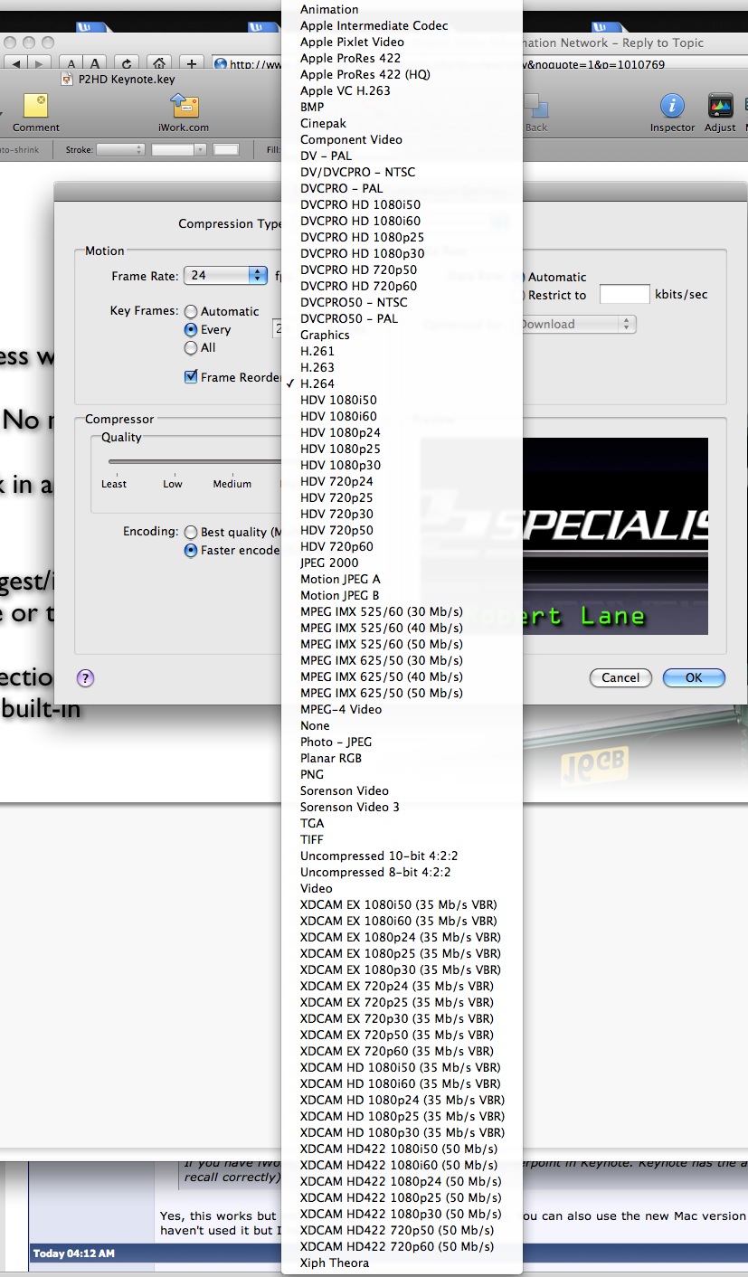

It might make more sense to take screen-grabs of certain sections of the PPT and refer to them in the clip rather than export the presentation itself as a movie. This is because you can't control how fast each slide is presented when it's transformed into a movie, the user is stuck with whatever cadence is created. And since many PPT's dont' even advance until the user commands it you might have to restructure the entire presentation to have a natural cadence.
Keynote is very capable of exporting presentations in any codec and quality setting that you can imagine; when you select a "custom" QT output you have the full range of options that you would using Quicktime Conversion from FCP including data size, frame rate, codec, sound options etc. This is far away more than PPT could ever accomplish. (see screen-grab)

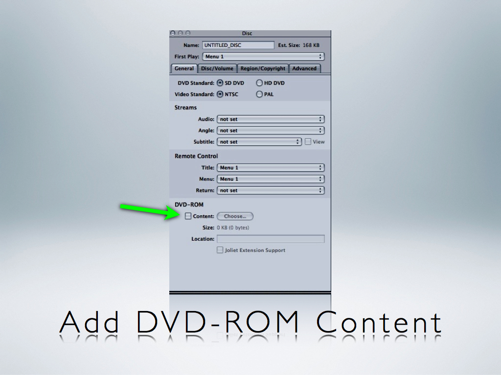

There is another option: you can add the PPT presentation as ROM content on the disk thereby allowing the user to actually put the DVD into any computer (Mac or PC) and copy off the presentation in it's original format and then play it in PPT or Keynote directly. DVDSP has this option - see image.
So you have a lot of options actually, you just need to choose which one fits your production best.
