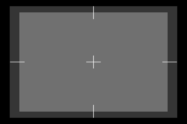

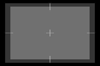

Here's a title/action safe still image I made awhile ago for SD (720x480). I would just place it on an upper video track (it should auto-scale to 225%), change the opacity to taste (maybe 30%), then turn the track on & off whenever you need a guide.
As Mike said, the top & bottom edges are the same, but this will give you a feel for the sides.
http://www.dvinfo.net/conf/attachmen...1&d=1235686038
4:3 title safe in 16:9 comp-titleactiongriddv.jpg

That works for me. Thanks.
