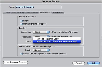

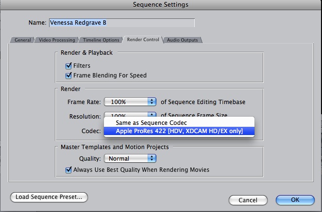

1) Use EASY SETUP. It makes things REALLY easy. Just go to Final Cut Pro>Easy Setup and choose XDCAM EX 1080p30 VBR. Make sure you choose the one with EX in the name. If you don't have any with EX in the name, let me know and I'll tell you the fix (thanks Craig!)
2) File>New Project and you'll be all set.
3) Select your Sequence in the Browser window (highlight it) and go to Sequence>Settings. Go to the Render Control tab and change Codec: Same as Sequence Codec to Codec: Apple ProRes 422 [HDV, XDCAM HD/EX only]. This will force FCP to render in ProRes instead of XDCAM EX. This will save you time and you'll have fewer problems (at least in my experience).
From now on, every new sequence you create will have the correct sequence settings for your footage. It will play without rendering. NOTE: Don't forget to manually perform Step #3 every time you create a new Project. Easy Setup won't do this step for you.

Final Cut Pro Sequence Render Setting. Avoids Long GOP Conform during editing.

Thanks again. I did understand what you were saying Mitchell, I had changed the setting under the Render tab, I just was just also checking out the other tabs to see what was there and noticed the General tab had those pixel settings. I wasn't sure if that needed changing, but after clicking on a few HD options I see that it really stretches the Viewer window out, which doesn't look right. So I left it at "Square".
If there were other options to change I'm sure you would have pointed those out anyway, I was just getting curious. So I'm all good now, I'll start editing this week. Then I'll have to sort out the downconversion steps for best outcome. I see lots of posts but no unifying best option.
