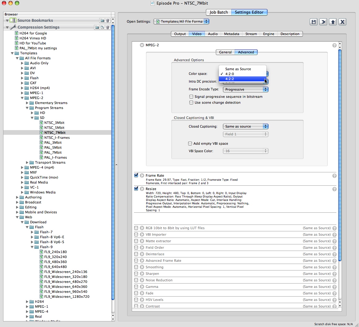

Sample
Here's just a quick sampling of the fact that even in a SD MPEG-2 encode you can create 4:2:2 output. I've not seen any other software-based encoder (with a possible exception to Squeeze since I haven't tested any version of that for over 4 years) that offers this flexibility. Period.
With exception to MPEG files intended for DVDSP4 E-Pro is my first-line tool for any encoding job, hands-down. It's just a shame that the price-point for the Pro version is so high, but then again superior tools are never cheap.
