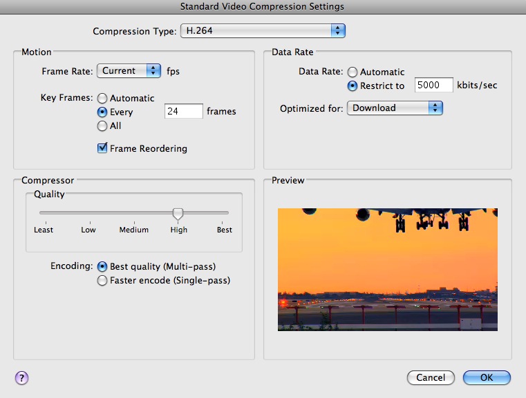

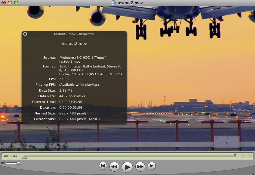

I don't know; I've never used that workflow but when I've entered your specs I get the nearest encoding rate possible. (see test pics) Maybe you mistakenly turned on/off another setting in the process? Or maybe FCP/QT cache is over-full and needs maintenance? (Onyx).
It's working as it should for me, so I'm not sure why it's not for you other than the possibilities mentioned above.
FCP not limiting data rate-picture-1.jpg   FCP not limiting data rate-picture-2.jpg
