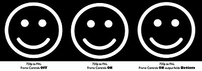

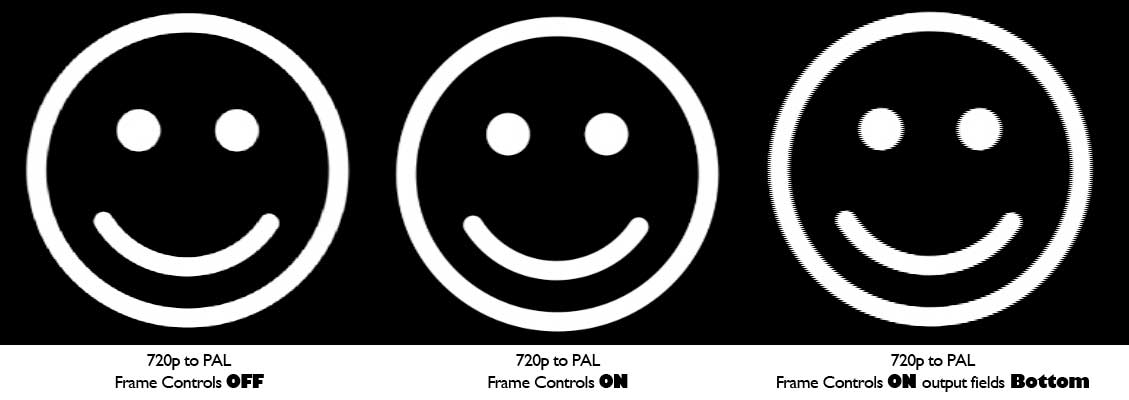

Frame Controls do work but...
Originally Posted by Paul Kendal View Post
My usual gorgeous output from from my custom presets (downsizing HD to SD-DVD using frame controls) now looks awful....almost as if frame controls have been disabled.....all kinds of stair stepping and aliasing now that I didn't have with the previous version.
You may have to remake them. I can confirm Frame Controls is working, as if I take the stock 'Advanced Format Conversions --> SD --> PAL Anamorphic', which has Frame Controls set to OFF, it looks like the proverbial pig's ear. Switch on Frame Controls and you get the improved scaling.
The illustration below based on downconverting 720p to SD shows a third option based on a 50fps original. Switching the Output Fields to Bottom First re-interlaces the movie for smooth video motion.
With bigger downscales you may need to move the Anti Alias slider up a bit.
