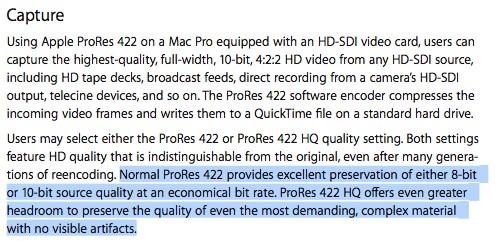

Mike - Your information is wrong here. Please see the provided screenshot from the Pro-Res white paper. Pro-Res 422 & Pro-Res 422 HQ are 10-bit codecs.
-C
True and false.
From what I see in that excerpt, I think we are both off a bit. The white paper states that Pro Res 422 preserves the 8-bit or 10-bit source quality, which I would interpret to mean that the Pro Res 422 transcode (in software) result will only be 10-bit if the source was 10-bit. The only way to get a Pro Res 422 version of DV or HDV footage that was 10-bit would be capture through an HD-SDI card (like the AJA Kona3, for example). Does that seem accurate?
Then is the only difference between Pro Res 422 and Pro Res 422 HQ the bitrates at which they encode?

This ticks me off. I didn't copy the white paper so you could add your spin on what it says. Most here donate their time to help others avoid confusion and you are not helping by interpreting Apple's documents. I'm not attacking you - just your erroneous information.
So, no, it's not "true and false"!
In this case it's only TRUE - The Pro-Res Line of codecs are and will ONLY BE 10-BIT! ALL OF THEM. Even Pro-Res Proxy, the crappiest of Pro-Res, is full, honest to God, 10-bit. It is all about bit-rate not (color) bit-depth with Pro-Res.
Apple has advertised this fact everywhere in addition to providing 10-bit claims in all their documentation (such as this white paper). Why would they lie? How would it be beneficial for your Pro-Res codec to determine your bitrate? Mike, with your line of thinking then your 8-bit DV up-converted to Pro-Res 422 720p and your 10-bit DVCPRO HD 720p cross converted to Pro-Res 720p file would be different file sizes.
Run the test, see if the file sizes are different. Better yet, read the documentation on Pro-Res.
