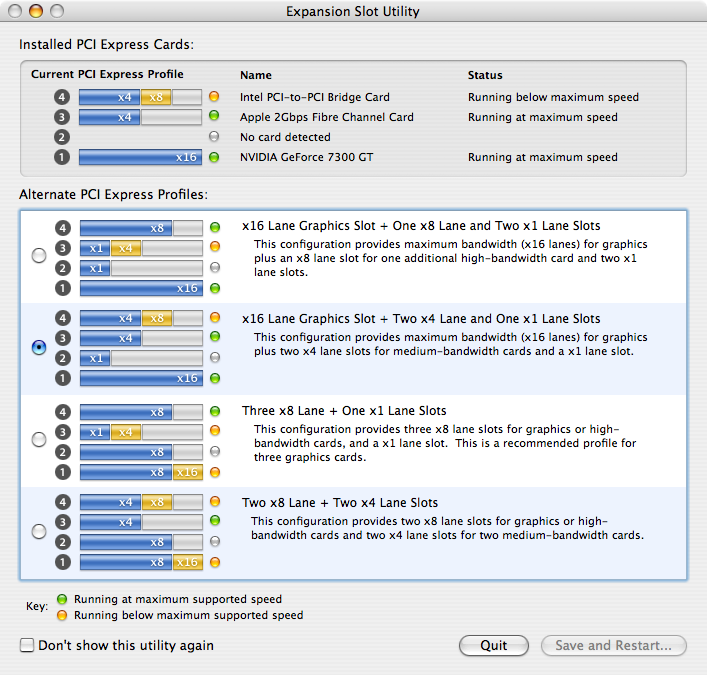

The Mac Pro uses this core app to define where certain cards need to go:
system/library/CoreServices/Expansion Slot Utility
Typically the card manufacturer will have a preference as to where it's card should go; the primary PCIe slot is always reserved for video.
Read the Apple support pages on how to access and configure your setup using this utility.
