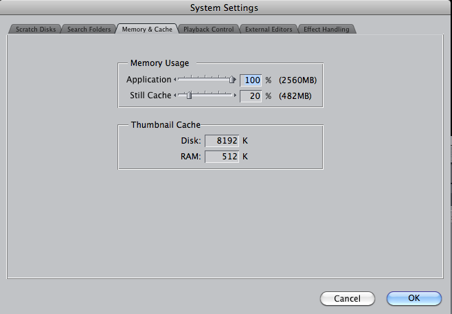

Josh, first of all have you allocated more ram for your still images by choosing system settings and clicking the memory and cache tab (view attached thumbnails). Itīs recommended to set the still cache to between 15-20%, but no more than 20%!
This could maybe help you in playing the still-sequences better?
Another thing, itīs not recommended to import large numbers of individual images into fcp, even if you adjust the still image cache settings!
You should instead use Quick Time Pro, selecting file - open image sequence, then file - export to a quicktime movie. Set the codec to ProRes 4444 if you are on fcp7 or quicktime animation if you are on a earlier version.
- Per Johan
