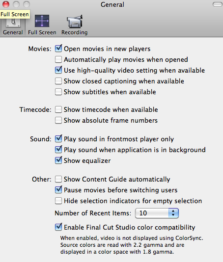

command-shift-4 lets you drag a rectangle and capture the part of the screen that it outlines. Post it here to show what you mean about not looking good when you stop.
For proper color rendering in the QT player, make sure you've set the Quicktime Player Preferences properly to set "Enable Final Cut Studio color compatibility"

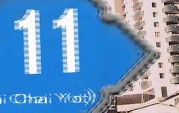

Here's the best (worst) example, the blue street sign is an animate png that passes from right to left allowing fro a cop transition behind it. On the FCP playback the '11' has perfect clarity.

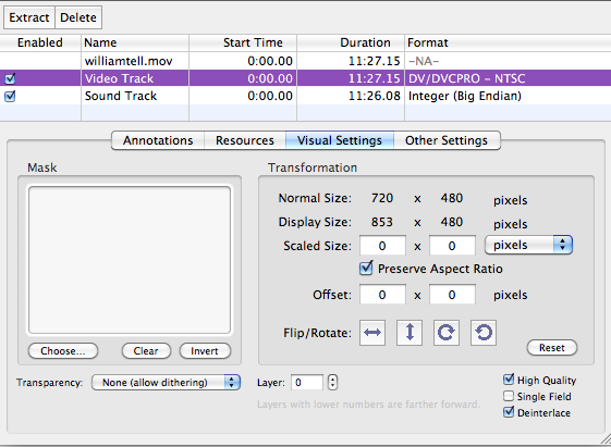

What you are seeing there is the effect of interlacing on an object or camera in motion. It's normal for interlaced timelines. If you are trying to get a still, you need to find a place in the clip that isn't moving. SOmetimes I'll get lucky with the QT Pro player by selecting deinterlace in the visual details settings (command-J) and take a screen shot off the player.
