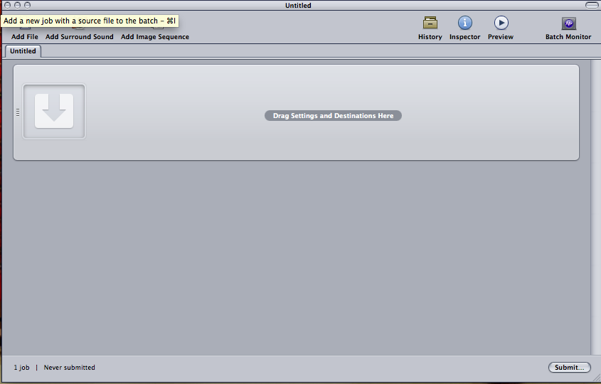

There are a couple ways to convert the sync'd footage to compressor. This is the way to do it in bulk without FCP involved:
Open Compressor
Drag and drop your files (using the Finder) onto the window called Untitled that looks like attachment #1

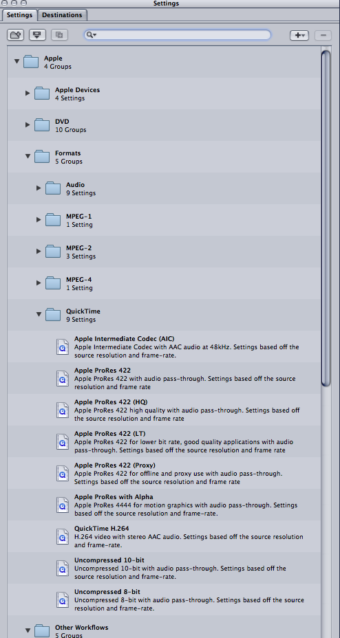

Using COmpressor Window Menu, open the window named Settings (command-3)
Untwist the preset compression settings as shown in attachment #2
Drag and drop the one called Apple Prores 422 on each file (Job) in your Untitled window
A faster way to do the above step is to select all the files (Jobs) in the Untitled window and leave them highlighted. Then drag and drop Apple Prores 422 onto the first Job. All the selected Jobs will get that preset dropped onto them
Click Submit and confirm you want to submit the job.
When it's done (I't'll take a while), you'll have transcoded files in the same folder as the originals but with longer names that include Apple Prores 422 in the name.
You can bring each one into FCP as usual
I'm not optimistic transcoding them will solve the sync problem. You can try it on just one file before spending the time to transcode all of them

Here's the attachments I forgot to attach.
it's my first time so be gentle:  7D footage -> fcp7-screen-shot-2011-12-07-6.38.35-pm.png   it's my first time so be gentle:  7D footage -> fcp7-screen-shot-2011-12-07-6.39.49-pm.png
