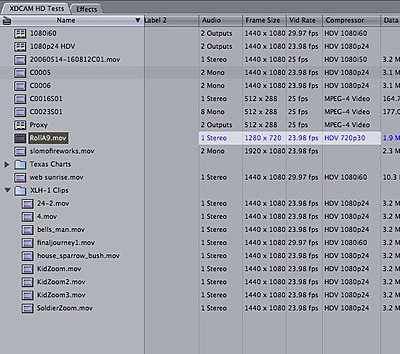

I just tested this. You now CAN make a 720p24 HDV file now using MPEGSTREAMCLIP. I just did it. Plays back in FCP just perfectly.
Take a look:
Take a look:
You are using the 720/30P Codec. Are you then just putting in the desired frame rate and the pulldown is correct?
Yes, I'm aware :-)
Well, you know there IS no pulldown. I tested it by bringing a HD100 24p m2t into MPEGSTREAMCLIP, and exporting unscaled, 720p30 HDV codec, but specifying the 23.98 framerate. MPEGSTREAMCLIP then ignores the repeat flags in the m2t and ames a frame for frame recompress into a Quicktime HDV file at 23.98. Too bad it's a recompress.
I decided to try this because I knew the HDV codec had just been updated in the last ProApps update, and that there's only ONE codec for both 1080 and 720 HDV, and 1080p24 HDV was a documented update in the new HDV codec.
Er, that and the fact Tim had mentioned it worked :-)
