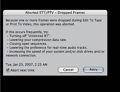

I am having a real problem with getting my now edited sequence to print to video. I have read several of the other posts here and followed the advise of other but I still cant get this worked out. Every time I go to print to video it will start to record and after a few seconds I get a window that pops up telling me that is was aborted. I occasionally get a similar message when I am playing back my sequence in the timeline and typically when I hit an area with either a filter, transition or title. I am on an IMAC G5 and have an external HD for my media files.
I changed my a/v settings to firewire basic which helped but now as I watch the screen on the Canon Elura (my deck) it will go from moments of video to blue screen while recording. This is the only way I can get FCP to transfer to tape but once I play it back the video is choppy, stuttery and seems there are dropped frames ever few seconds. I have been at this for 6 hours now and have given up at this point. Any help on this matter would be greatly appreciated.
I have attached a grab of the message box also.

Print to video is a really finicky thing in FCP. A firewire drive that works fine for capture may not allow you to print to video. Tell us some more about the external drive. Is it a relatively new 7200 RPM drive? Drives slower than 7200 are not likely to work well. Older drives sometimes have slow chipsets in them which are a problem. How was the drive formatted? I've found that you must format your drive as MacOS extended and turn journalling off. For me, this was the "magic bullet" that solved my print to video problems.
How full is the drive? Does it have a lot of small files on it? Ideally you want a drive with a fair amount a free space and relatively low file count to insure that it isn't fragmened. If possible, copy all your files to another drive, then reformat it with journalling disabled and copy the files back onto it. Also, close all uneeded projects and sequences before printing to video.
But you may still have problems. You might need to export your sequence to a Quicktime file, then create a new project and drop that file into a sequence. This might give you just enough more performance to make it work. OTOH, your computer and drive just might not be fast enough. Print to video is very particular, and lots of people seem to have problems with it.
BTW, you can uncheck that box in the error message and the video printing will continue even if frames are dropped. Depending on how bad the problem is and what your expectations are, this might still give acceptable results.
