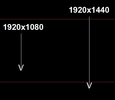

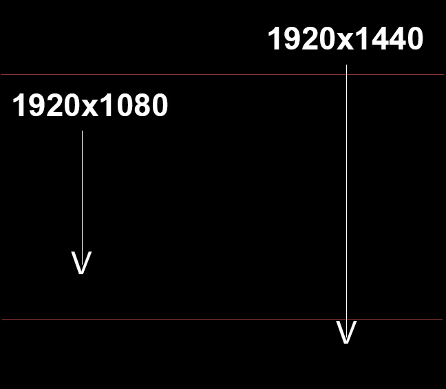

I'm not 100% sure either but this is my thinking:
The frame from the GoPro is 1920x1440, which is a 4:3 image. If you crop the top and the bottom, you're only cropping the pixels between 1080 and 1440, and you're left with a 16:9 1920x1080 image. So I don't think anything is being stretched in this case, just cropped.
See attached very rough (not to scale) image to illustrate my point. Again, I could be wrong.. just my best guess.
OK I've got to the bottom of it :-) The figures you are quoting are from the GPH3 Black version, which does indeed give a 1920 x 1440 pic at 4:3. This means that you can crop down to 1920x1080 still retaining the full 16:9 pixels. the bad news though is that the 4:3 pic is already reduced from the higher 2704x1440 17:9 resolution. I was puzzled because I have the GP3 Silver, which has the highest res at 1920x1080 16:9, whereas the 4:3 pic is at 1280x960.
So basically, the 4:3 is a reduced pixel count, but on the black version you have a higher starting point.
Roger
