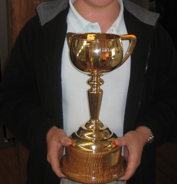

We need to get some great footage of a cup - it's gold and reflects EVERYTHING. We tried surrounding it with black cloth then flooding it with light but it's still pretty average.
I'm thinking of trying dulling spray but that takes away the effect. watching the footage of this cup needs to be a religious experience. I need there to be a real sense of awe and wonder.
any ideas?
I've attached a snapshot of the cup for reference

This might be an odd thought, but how about using a large mirror and taping the cup's reflection in the mirror? okay It might sound nuts, but it's an idea. LOL.

not a bad thought - normally with the right angle you would only see the reflection but the cup itself is a sort of mirror and might reflect that ...
and even if you couldn't see the camera or the mirror - you would still see everything else.
I've been thinking of setting up some large lights and using a smoke machine to hide the rest of the room

Have you tried changing the shot to a lower or higher angle? If you went higher, maybe the top of the cup wouldn't reflect so badly - may compromise the shot though. Maybe an shot on full telephoto from a balcony would work -I'm imagining that reflections are OK so long as the camera isnt in shot?

What kind of footage do you need? ie will the cup be on a table and the camera be moving around or will someone be holding the cup in the air and moving around?
Or will it be a static shot? In which case does it have to be a real cup or would a 3D CGI cup work as well?
Assuming the real question is how to keep the camera's reflection out of the picture, then here are some random thoughts.
Is there something that could hide the camera reflection like a pile of books on a table with just the camera lens aiming from between a couple of books?
If the camera were far eonough away in a dimly lit part of the room and zoomed in on the cup its reflection might not be so obvious. Maybe even behind some curtains with just the lens sticking out. Or shooting from outside the door of the room with no light on the camera
I remember using a view camera to take still shots of setups with mirrors in them and offsetting the camera and using lens shifts to get the camera reflection out of the picture but this wouldn't work so well with an object like this.
Shooting from a low angle (maybe even from below the edge of a table) and then fixing the perspective in After Effects or something might work to minimize the reflection.
