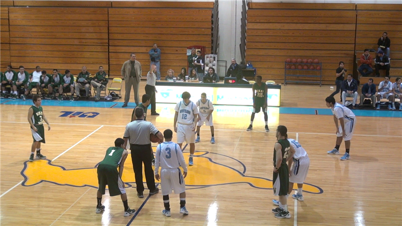

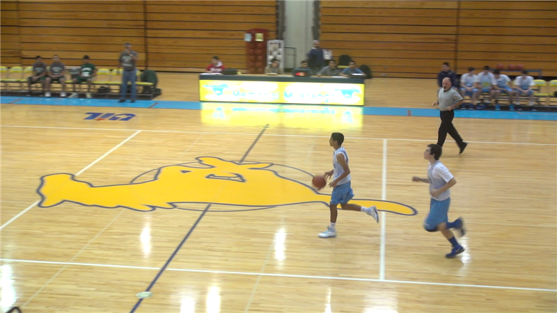

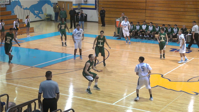

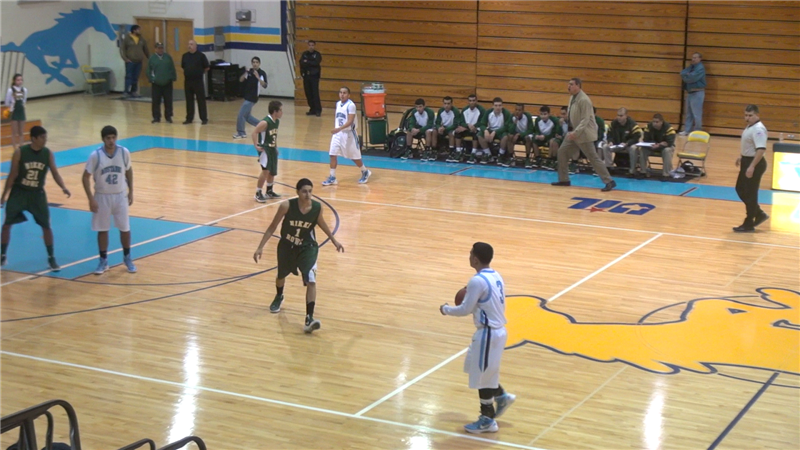

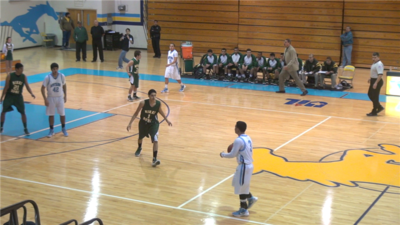

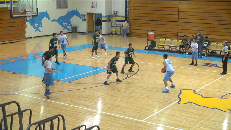

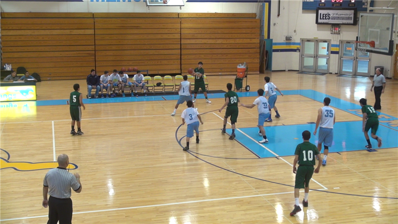

Here are some stills from a night and day game, overall a huge improvement. The gym has skylights so the day game lighting is much better than the night game. When in the center of the court the light from the sign will always be an issue but the action on both ends of the court is much better. Still having little issues with focus searching but I believe the lighting is just so bad the camera is having issues finding something lock onto.
The first 3 stills are from the night game and the next 3 from the morning game.

Even for low indoor gym lighting, everything should be on manual : WB, aperture/iris, shutter speed . Since the gym is lighted fairly evenly except for the glare, you don't want your exposure changing when clusters of light-colored uniforms enter and exit the frame.
At your distance, focus should also be on manual.
