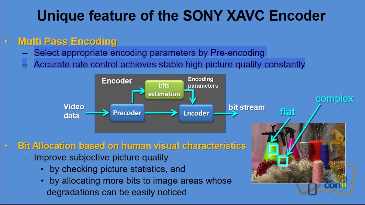

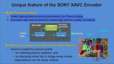

Not necessarily so! Oh I wish it were all as simple as that. It's very hard to make direct comparisons bit rate for bit rate when quite different and often proprietary encoding techniques are used using proprietary algorithms, DSPs and FPGA's as in the case of Sony with its XAVC codec. This applies to all their XAVC codecs right through to the F55 camera for example.
In Sony's case they specifically developed their XAVC format ecompassing H.264 like many other manufacturers but in Sony's case they are the only ones to date who in real time multi-pass and "Select appropriate encoding parameters by 'pre-encoding' for accurate rate control which enables them to achieve stable high picture quality constantly at much lower bit rates." as they put it. Why are Sony the only ones multi-pass pre-encoding H.264 in real time? Sony have been consistently ahead of the curve when it comes to developing very high speed DSP processing which is used very heavily in real-time encoding. Most other camera manufacturers are constantly playing catch up with Sony in this particular field of technology.
This why people are often confused as to how often Sony seem be able to deliver a quality level that belies the bit rate the vision was encoded at. Sony's VBR 50Mbps XAVC very often, scene dependent to a degree, will be as good if not better than some competitors 100Mbps and sometimes higher bit rates. Especially when comparing 4:2:0 with 4:2:0. The biggest grading improvements tends to come with greater color depth as mentioned above by Seth, 4:2:2 vs 4:2:0 not necessarily bit rate is the big helper here.
So don't be surprised if you get very similar results between Sony's 50 versus Fuji's 100. Both need handling with care as neither are high bit rate compared to some of the 600Mbps and up XAVC flavors.
A bit more of an explanation can be found here:
https://bento.cdn.pbs.org/hostedbent...2013-v05_1.pdf
