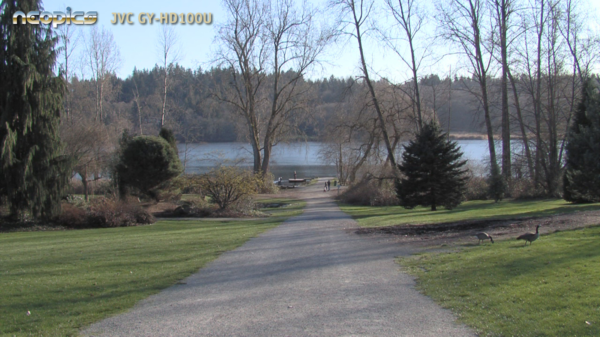

For reference, here's an example of a JVC HD100 still upconverted from 720 to 1080:
TIFF / JPG
Earl Thurston is offline   Reply With Quote

Thank you everyone for your thoughtful responses.
Keep them coming.
It's funny... Earl's Tiff to me looks as good as filmstock from my favorite 70's films. I love it. I imagine the engineers are going to hate it.
TIFF / JPG
Uprezzed how? That's the big question.
In this instance it was simply a still scaled in Photoshop, but I get the same result in After Effects. However, consider this example "optimal." Once one adds a codec into the mix, it's a different ball game. I just provided it to show how 720 could look at 1080.
