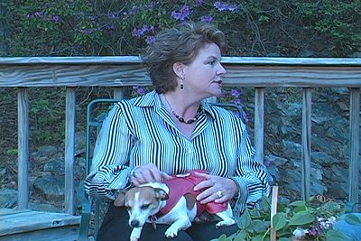

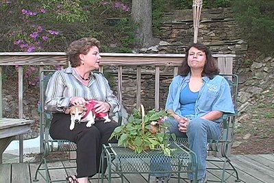

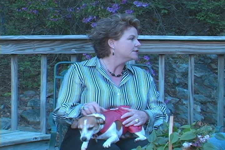

I have some shooters who occasionally forget to white balance the cameras. The few times it has happened I have loaded up the clips, applied the Color Balance filter on the bad clip, opened the vectorscope and used the RGB values displayed for a point in the good clip and fiddled with the color balance settings until the good clip had the same values.
That process is just not working for me this time. Can anyone point me in the direction of a tutorial for correcting white balance in post? I do not understand the process to use the White Balance filter in Edius so I used the Color Balance filter before with limited success.
Attached are stills of the shots in question. I have tried to match up (using the above process) the green leaves of the plant in the foreground,the shirt, the tan color of the basket in the forground and the white on the dog......all with lousy results.
Reshoot is not really an option as this was the reshoot for an earlier nightmare.
Any advice?

if your shooters aren't shooting right, then either retrain them, or restrict their payments until they get it right.... the only way theyre going to learn is when you are adamant that their work is unaceptable
moving on...
tell you shooters to NOT try to correct the WB midway through a shot/scene this way even if it may be off, you can correct the shot/scene uniformally so as to fit with each other.
Edius has white balance filter and a pretty nifty CC filter. frm memory i think its also got a colour match filter
Thankfully they don't.
As posted in the original post, I don't understand the use and controls of the WB filter, and have used the CC filter with limited success. I have not yet seen a color match filter but will look again.

Go to http://ediustraining.grassvalley.com/ and then watch the White Balance filter video... it might help you out :)

Add a little orange to it, if you can't find or figure out the color corrector, put a layer of orange over it and multiply the layer and lower the opacity to get it to scrub out the blue just slightly.

Nice tip! I keep forgeting I can build things up instead of just working on what already exists. I did finally get the white balance controls to work. Once you know how to grab another frame for a reference its almost childs play.
