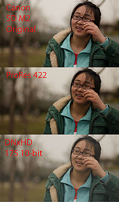

I just did a transcoding test on my Mac.
It's hard to tell in the attached example, but the ProRes is slightly darker than the original but the DNxHD is noticeably brighter than both.
Should I try on the PC to see if it makes a difference?

Posts: 4,100
Use RGB on the DNxHD and see if that solves your problem.

I tried the RGB option instead and got the same washed out look, unfortunately.
In the meantime, I used ProRes instead on both Mac & PC and it seemed to work fine so far.
