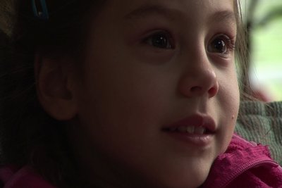

RE your simple method - I tried it before and I did not like it, or maybe I did something wrong (but the resulting DVD was worse than DVD produced from SD DV). I understand, that downconverting (which is elimination of detail) must happen in a smart way, not just by way of simple resize.
I'm not sure what might have happened in your case - I am happy with the quality of resizing in VDub. See attached sample from a quick test with no other filtering than the resize. It gets a lot better with sharpening, which I did not do on this sample.
