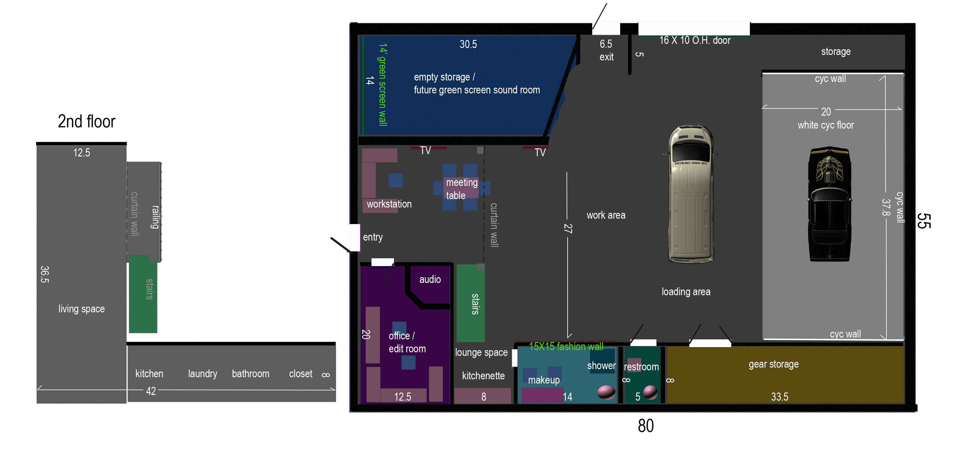

With your latest design, looks like you’ve moved the audio recording booth away from the outside wall, further into the building David. That should help isolating from any sound coming from outside the building.
Don’t forget to run tests for spurious Radio Frequency interference at different times over 24x7 periods at various points in the site, before you start any construction.
Now’s the time you need to find out if you have to cover your whole place in chicken wire, like we nearly had to do, before we settled on a star ground electrical wiring system.

I would like more info on this please. Is this issue you are describing an interferance issue with wireless audio due to the building's electrical system? Or is this issue related to radio interferance from the location the building is built in? I haven't checked the air waves at the locations I'm thinking about buying yet...oooh
David Banner is offline   Reply With Quote
Old October 21st, 2021, 07:40 PM   #35
Join Date: Mar 2015
Location: Bentonville, AR
Posts: 242
Re: Cyc walls - build or use pre-fab?
should I angle the wall of the green screen room would that help?

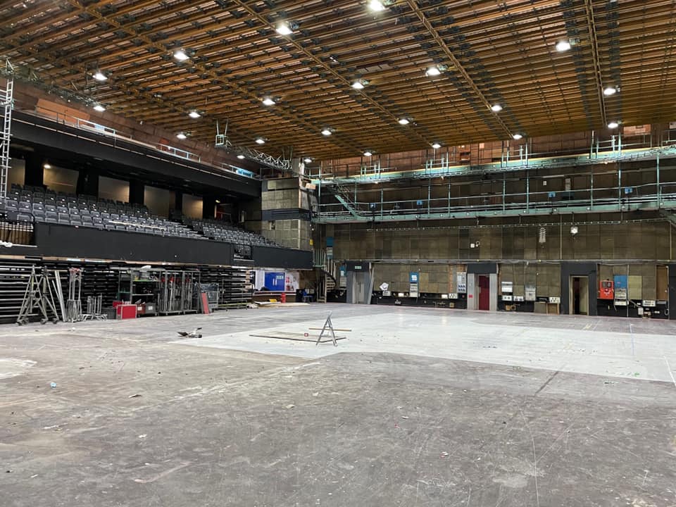

Sound treatment doesn't always have to be clever or technical and mega expensive. Film studios, and larger TV studios have frequently used timber battens vertical on the wall, 2" deep, with rock wool in the gaps - covered with chicken wire to prevent the Rockwell falling out. Looks horrible, but while rock wool this thin does little for sub 500Hz, it's very good at deadening the 'big' sound you get from slapback from the parallel surfaces. As you usually cover the walls with drapes or green cloths anyway. There are some big studios waiting to be knocked down on the Thames in London - and in this picture you can see this kind of construction - I found another picture from 2016 when the place was in use - I loved it there.
I'm very interested in the comments about screened mains wiring. In the UK this is very rare. Where there are large EMF fields, we'd still put cable in steel conduit, but I do have to say that I have never deviated from our standard wiring scheme here, which is ring circuits, NOT radials. Our power for control rooms, and all normal areas would be flat twin and earth in 2.5mm2 size, rated at 32A. In practice this means audio equipment, for example is actually enclosed in a ring main, surrounding it - nowhere to hide. We don't get problematic interference. I've never done a noise survey on radio mic channels, for instance. Never had to stick the studio in a Faraday cage. The BBC for many years had technical earths (grounds) - as in a totally separate clean grounding network throughout a building, leaving the mains grounds to just be there for safety purposes. The jury was always out on the technical ground as it only took a single badly designed piece of kit that had the mains earth attached to the chassis for it to introduce hum into a quiet system - usually when bolted into a 19" rack. Technical grounds are now quite rare. Where screening is required - maybe to make absolutely sure there is no leakage from cables feeding dimmers, etc, then the dimmers would be fed locally from a distribution point, and that point wired back to the intake with Steel Wire Armoured cable (SWA) with glands grounding both ends. Now we're into LEDs, the higher current supplies seem to be vanishing. My 63A 140V single phase outlet in my studio is empty most of the time - my current consumption has gone right down. My floor area of course is smaller, but mains borne interference and RF interference isn't an issue at all for me, and hasn't been for years.

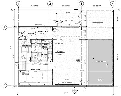

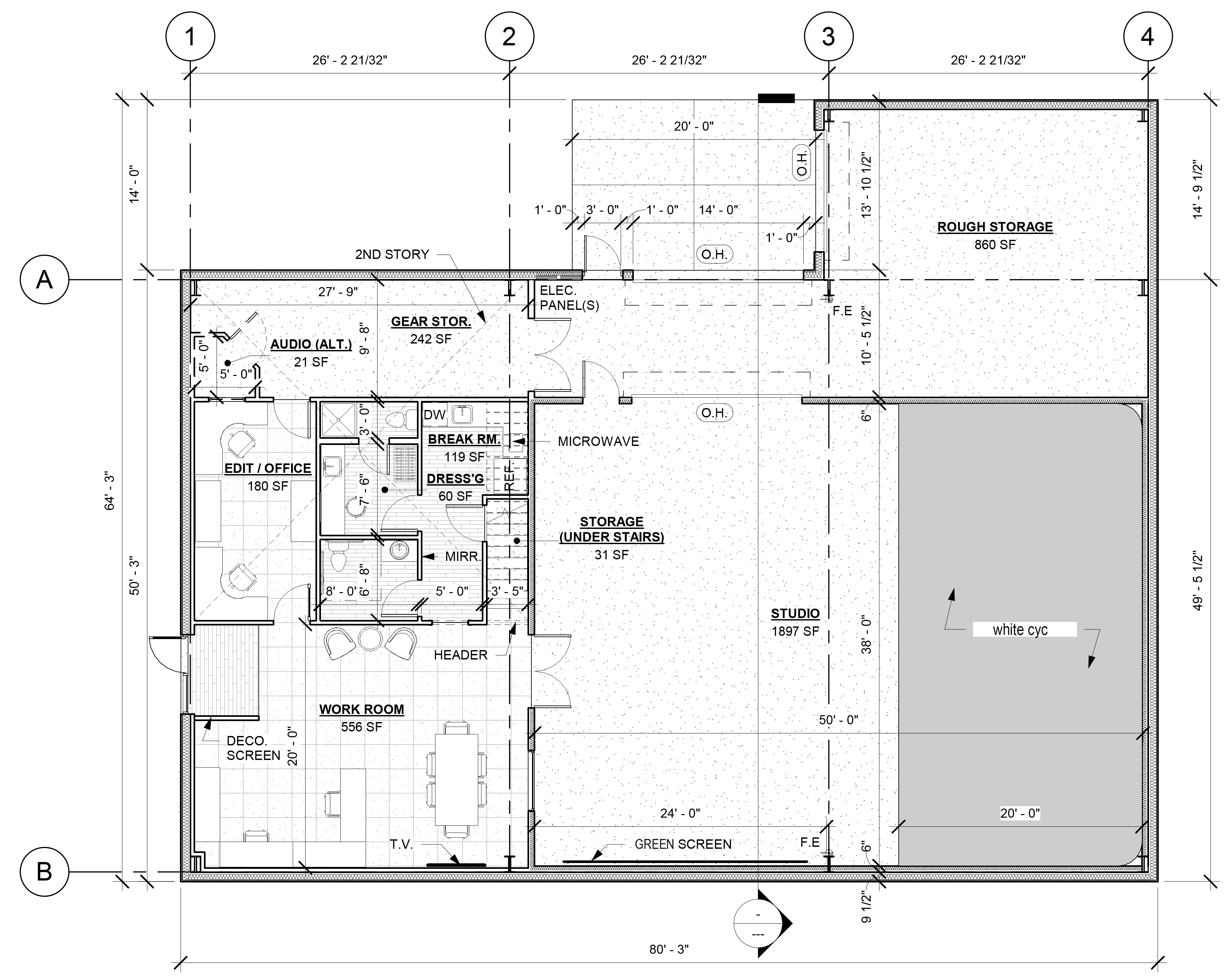

Hi again. Wanted to share update. We've been working on design and fixing some things.
Here is our plan.
Planning on building a box building inside of a PEMB box building to isolate from exterior noise.
Plan on having large black curtains that can slide around to cover up things in side the studio as needed (such as green screen and OH door).
Do you recommend the electric panels being where they are or inside the studio?
I'm thinking to increase the audio booth by another 6 or 8 inches to allow for more space to compensate for interior deadening
