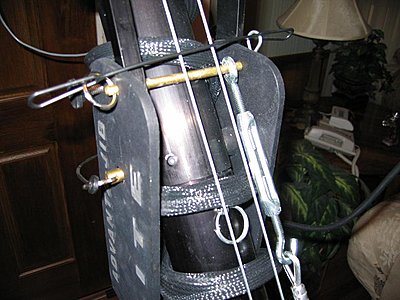

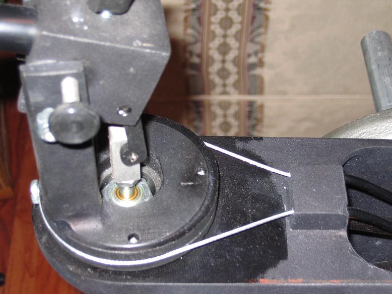

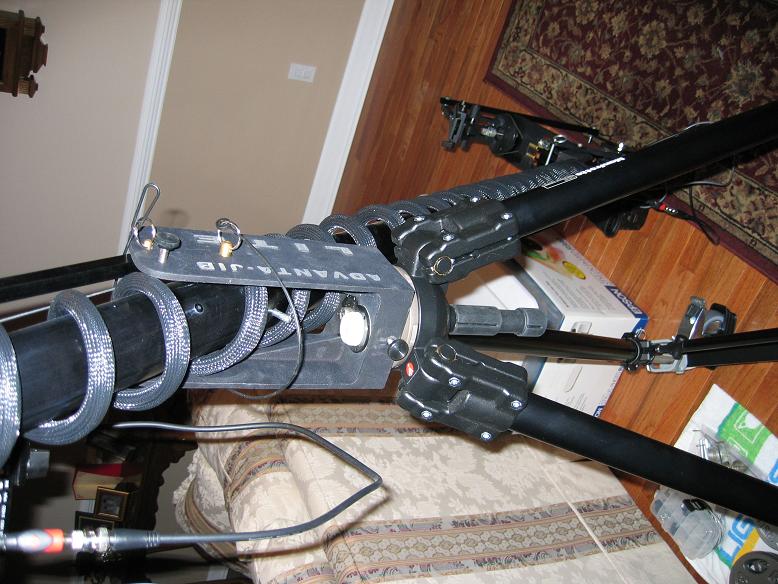

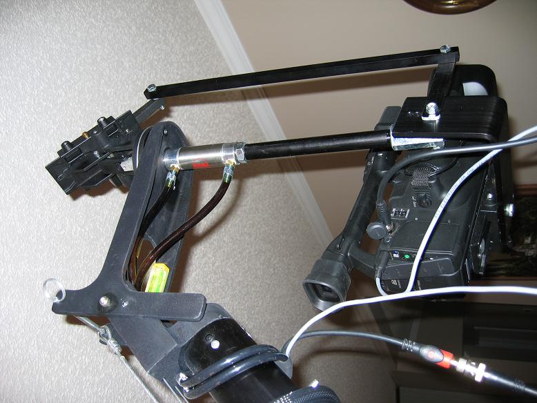

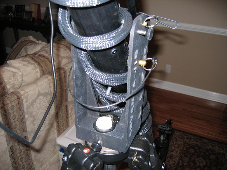

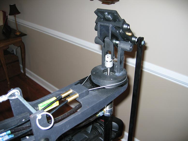

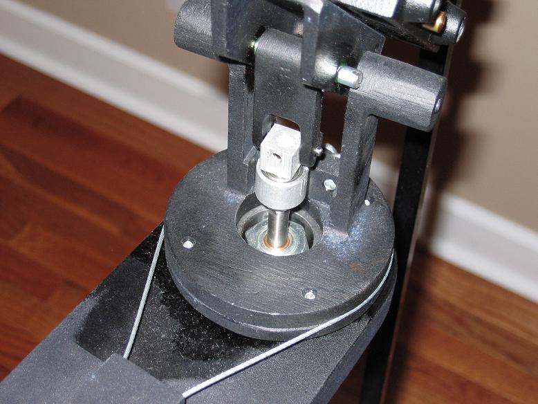

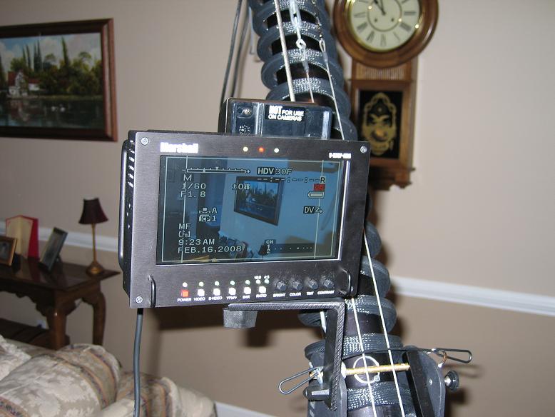

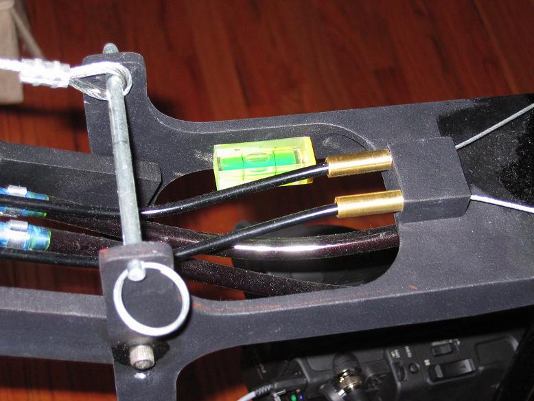

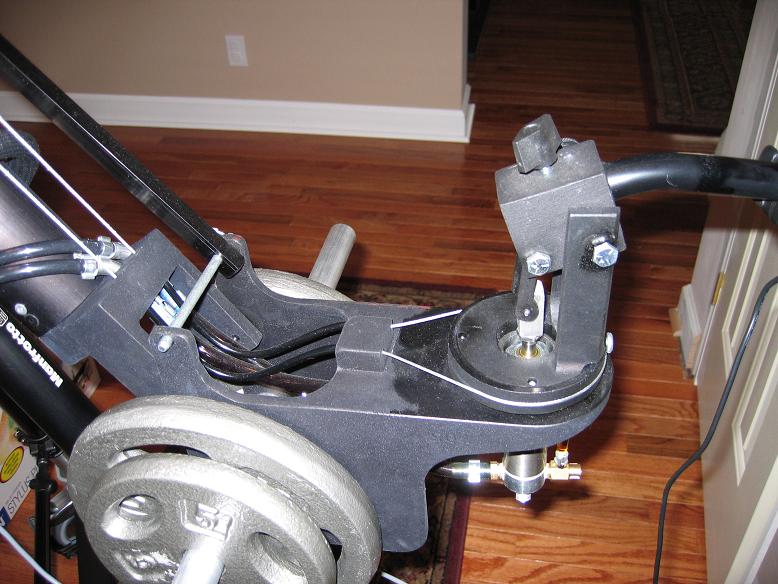

Pictures as requested. Let me know if you would like any others.
advantajib reviews/testimonials?-img_1952.jpg   advantajib reviews/testimonials?-img_1953.jpg
advantajib reviews/testimonials?-img_1954.jpg   advantajib reviews/testimonials?-img_1955.jpg
advantajib reviews/testimonials?-img_1956.jpg   advantajib reviews/testimonials?-img_1957.jpg
advantajib reviews/testimonials?-img_1958.jpg   advantajib reviews/testimonials?-img_1959.jpg
Hart Boyd is offline   Reply With Quote

Awesome!
Hart,
Thanks immensely for the reply and especially the photos. Thats really really fantastic. I was worried the reason there were no large photos was because it looked bad up close or something. Your post sold me!
If you ever have a chance to post a pic of the section where the jib mounts on the tripod, that would be great. However, i plan on buying, so if you dont get around to it, i'll just photograph my own and look at those.
Thanks again! You rock!

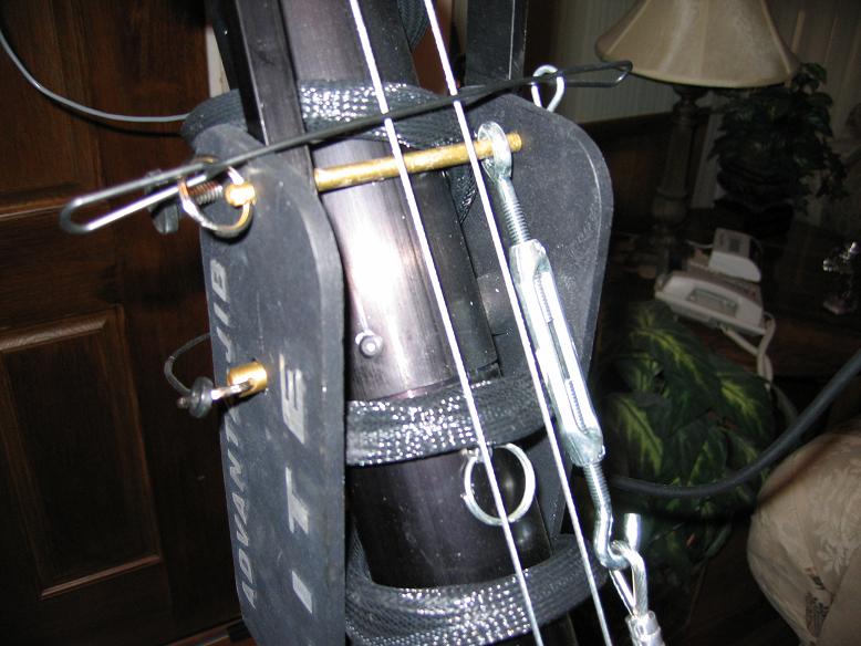

Old February 17th, 2008, 02:19 PM   #11
Location: Atlanta, GA
Posts: 148

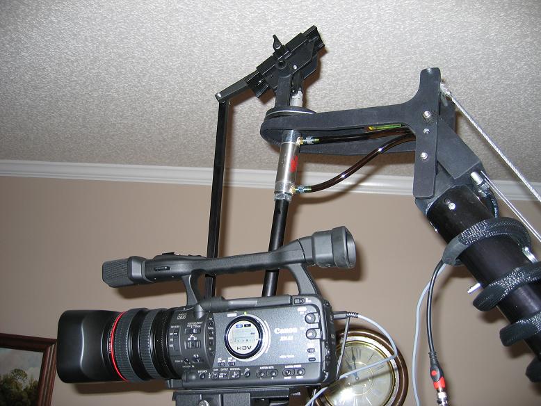

Glad I could help. Here you go.
advantajib reviews/testimonials?-img_1960.jpg   advantajib reviews/testimonials?-img_1961.jpg
advantajib reviews/testimonials?-img_1962.jpg

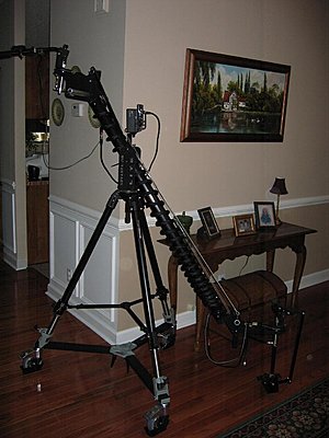

Hi Hart. Could u post some overall photos of the entire crane? Looks like a nice option since it has pan tilt functions over the rest. The price point reasonable if it works well :)

I will try to take some tomorrow. My sits on a Bogen 528XB tripod with a Bogen 3067 dolly under that. Do you have something in mind that you would like to see?

Here is an overall picture of the 7' jib on the tripod & dolly. The underslung head is attached with no camera mounted or weights.
advantajib reviews/testimonials?-img_1963.jpg
