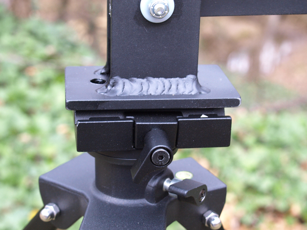

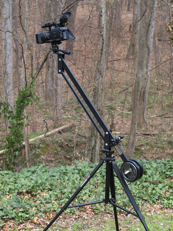

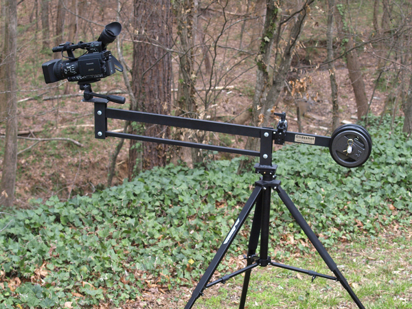

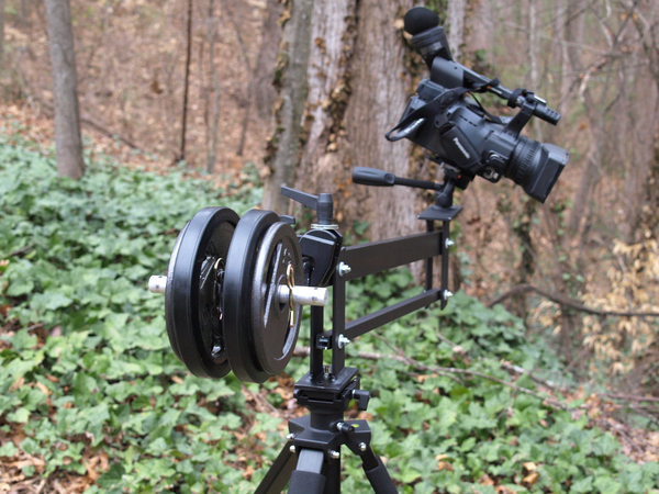

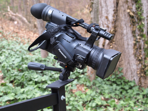

Mark, here are some photos of my rig. Another good thing about a short jib is you can use your camera LCD screen for framing. BTW the first time I used it I was hanging out over a small waterfall. It was a little scary.
Glideshot 5' Tilting Jib, thoughts?-p1014488.jpg   Glideshot 5' Tilting Jib, thoughts?-p1014494.jpg
Glideshot 5' Tilting Jib, thoughts?-p1014491.jpg   Glideshot 5' Tilting Jib, thoughts?-p1014496.jpg
