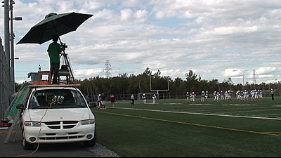

Here's my son 9 years ago. Of course the van isn't hurtling down a bumpy road but in some circumstances it works lol
