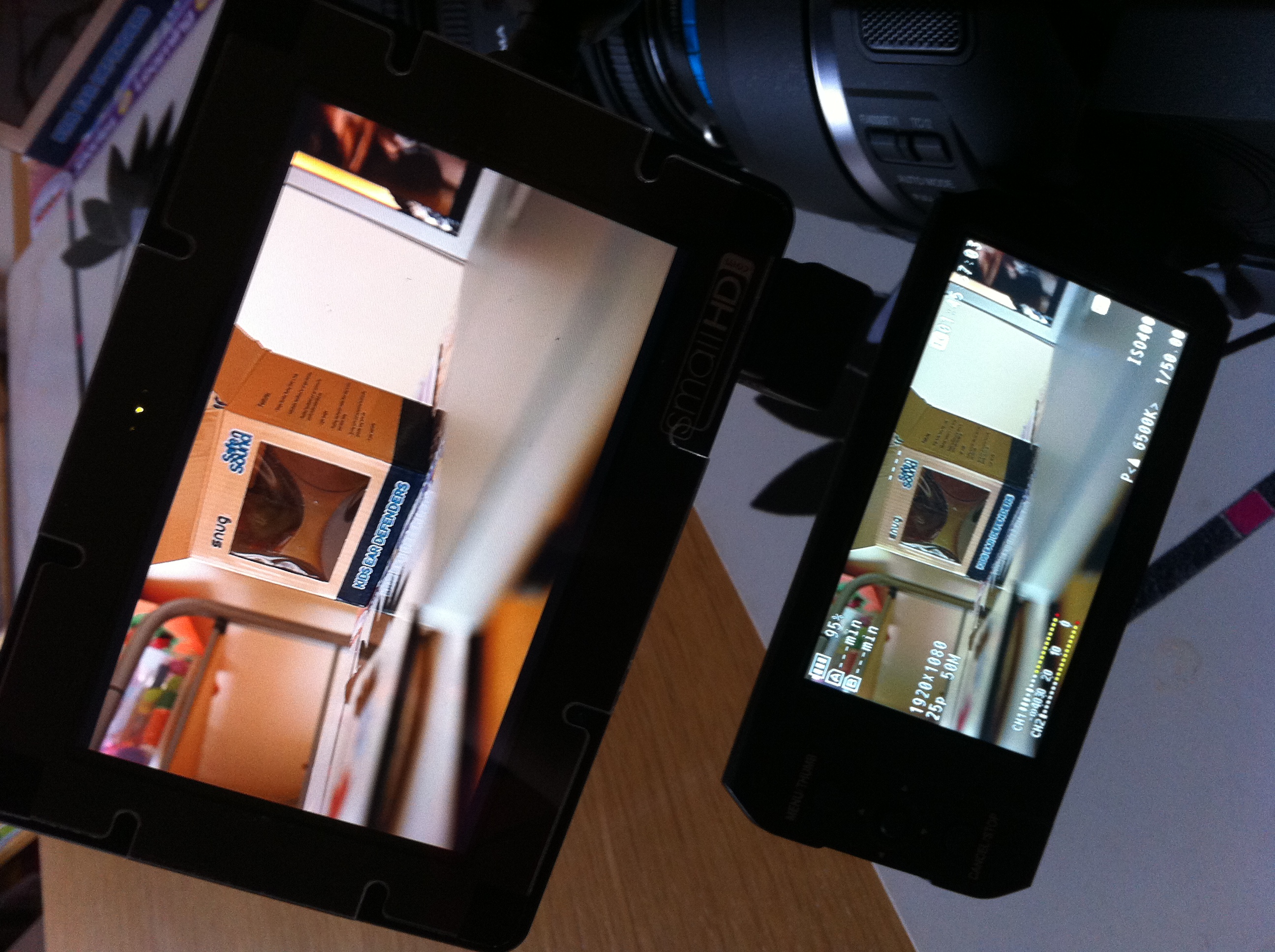

Here' a Small HD monitor next to the built in sidefinder.
Skin tones seem muted on the sidefinder, making some shots look very odd.
I guess it just takes some getting used to.
Also a question for those in the know.
When I record in 4:2:2 and import into FCPX the whites are clipped at 100%.
All the other codecs/bitrate combinations import with superwhites intact.

That's pretty disconcerting to me. Although I have a SmallHD monitor I use for carefully setup shots (like interviews, etc.), I currently use a Panasonic AF100 for cinematic look in run & gun situations - and don't know what I would do with any worse built-in monitoring solutions than that cam itself has (which are not awesome but at least robustly built and "true" to what is being recorded).
The addition of a histogram to the LS-300 really piqued my interest, but - assuming you calibrated everything - the disparity between what the two screens are showing is pretty big.

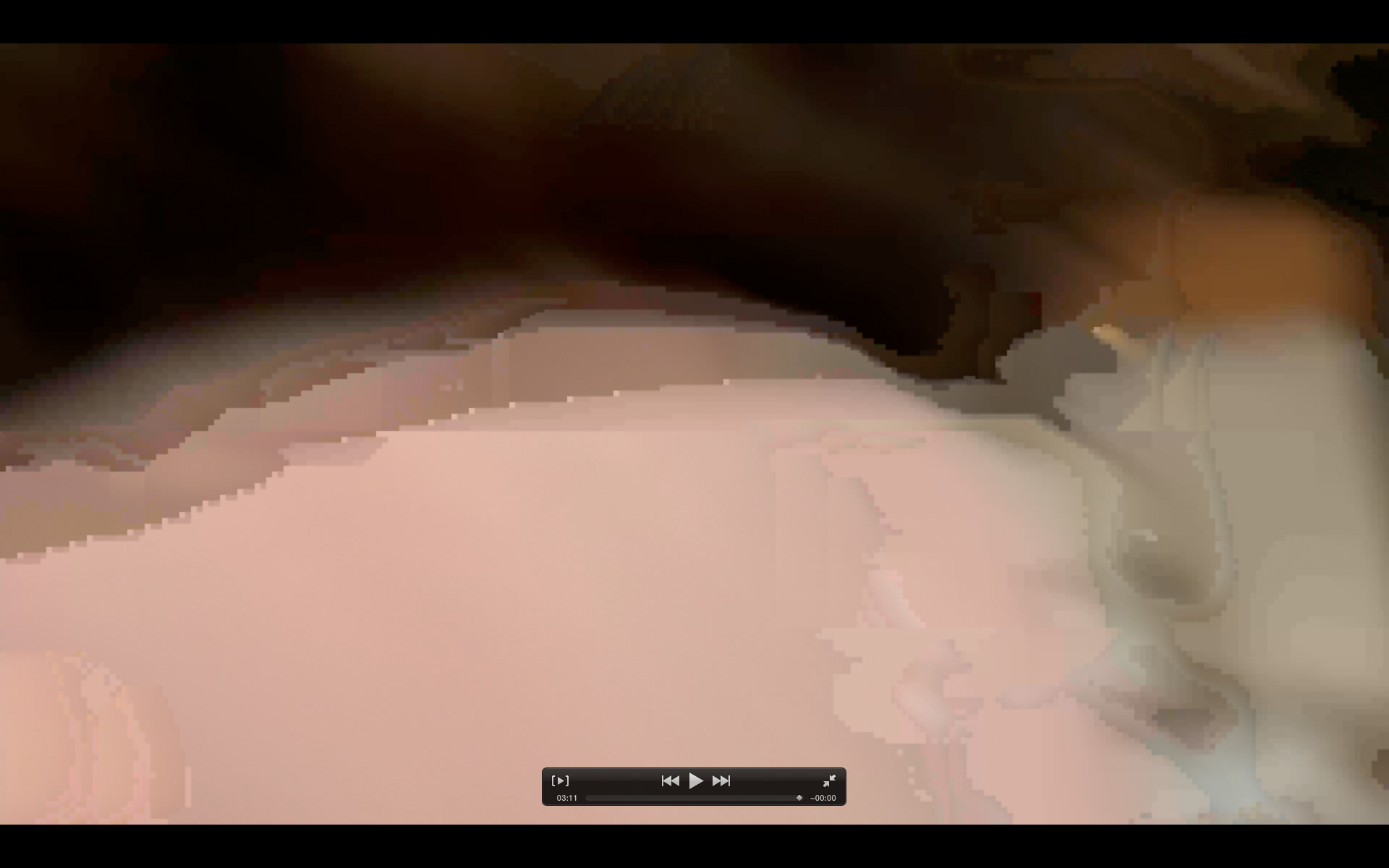

I'm currently cutting the first UHD project from this camera.
Some camera movement seems to break the codec very easily resulting in macro blocking.
I filmed a sign on a door, as we closed the door and the signage drops into focus.
Large areas of almost block colours, plenty of out of focus areas, not full of detail, but the counter movements of the reflection moving one way and the lettering on the door moving another way seems to confuse the encoder...
Once or twice where the camera recorded really ugly breakup where I was hand held and chucking it around. Finding shots etc.

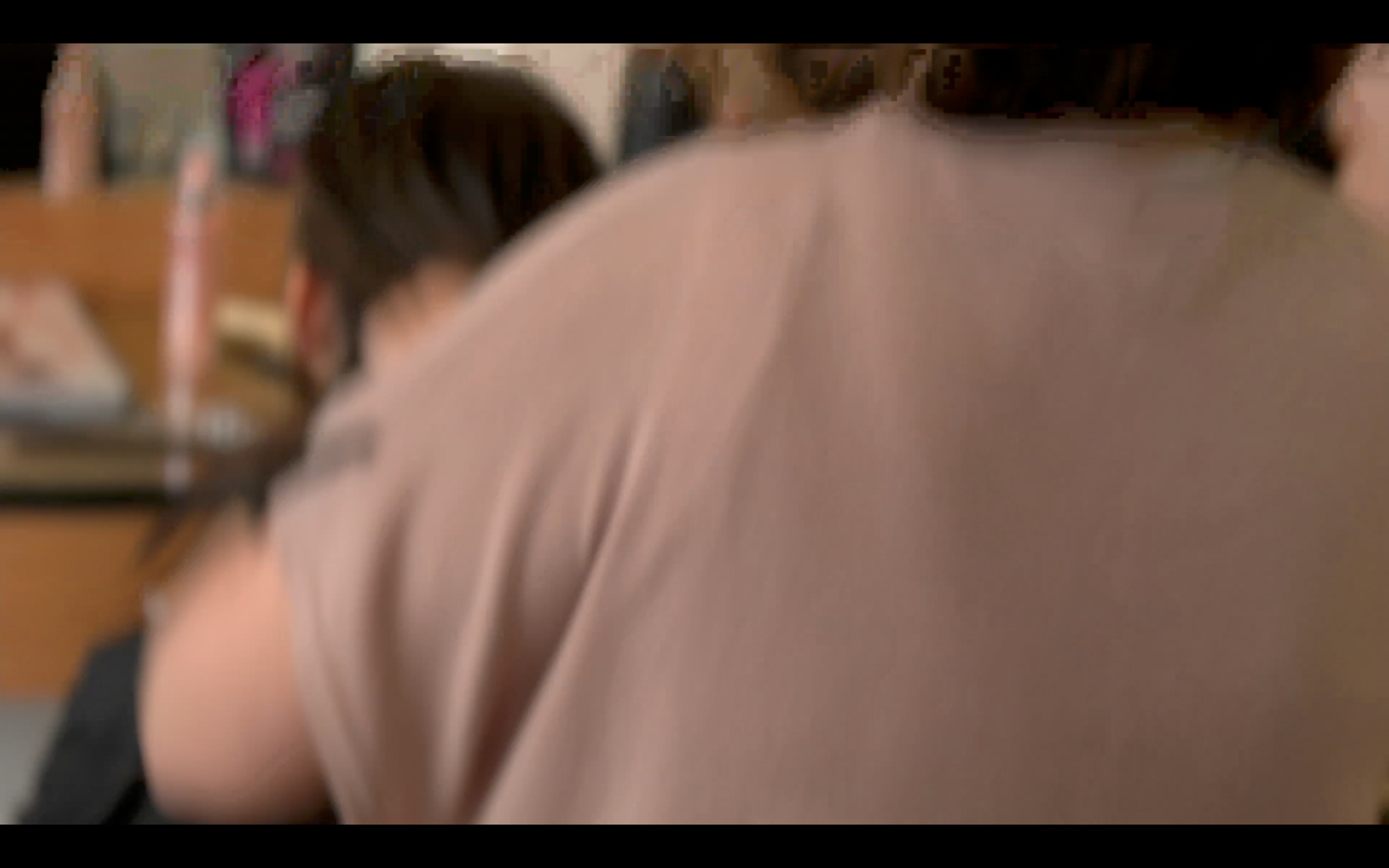

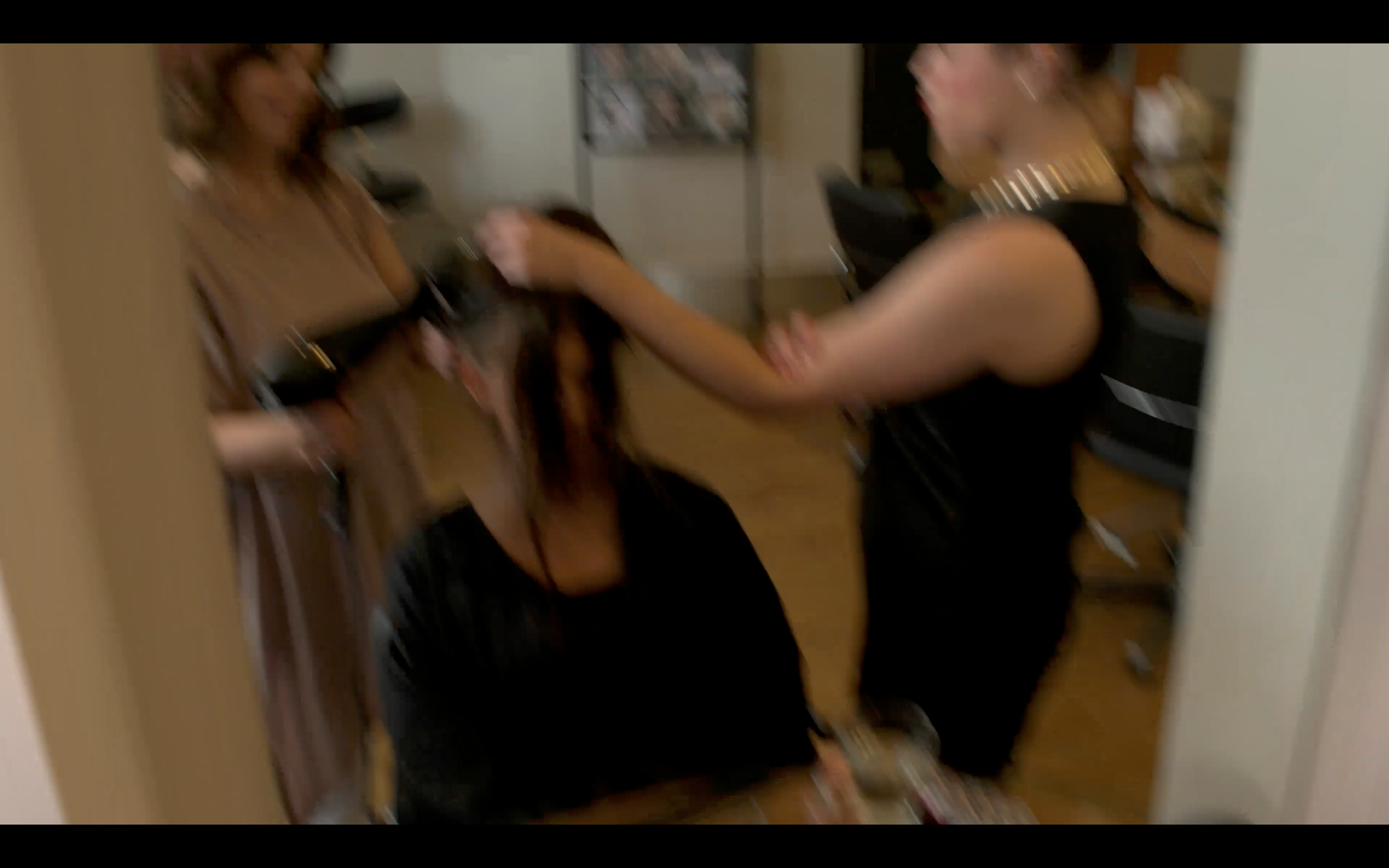

Here's a few examples of the camera compression issues I've had as I've been editing.
I'm shooting an HD job tomorrow.
Once I'm back I'll update the camera firmware, as I've seen there was an update earlier in the year.
Although it says it only fixes Metabones issues...
Upcoming New Features for the GY-LS300 Announced-screen-shot-2015-08-18-17.01.03.png   Upcoming New Features for the GY-LS300 Announced-screen-shot-2015-08-18-17.01.32.png
Upcoming New Features for the GY-LS300 Announced-screen-shot-2015-08-18-17.01.55.png

The examples I posted were shot in UHD.
And there's only one bitrate option available at that resolution: 150Mbps.
I'll do a firmware update and see if it helps.

I managed to find a newer version of the firmware, no thanks to the rather unhelpful website.
So far I have been unable to recreate the really bad codec breakup which is good news.

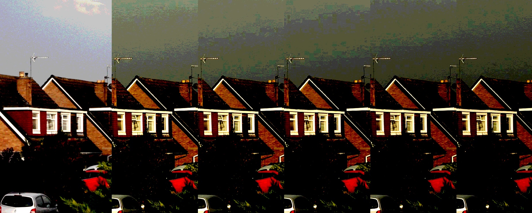

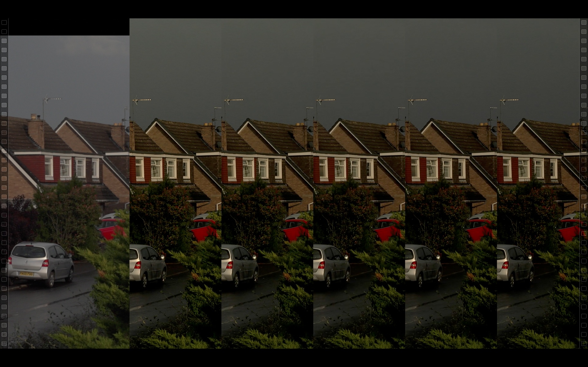

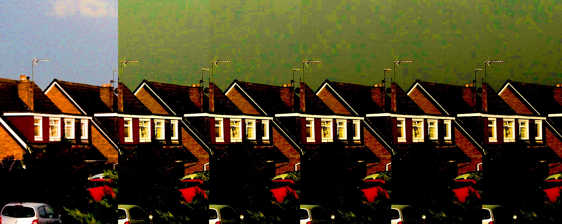

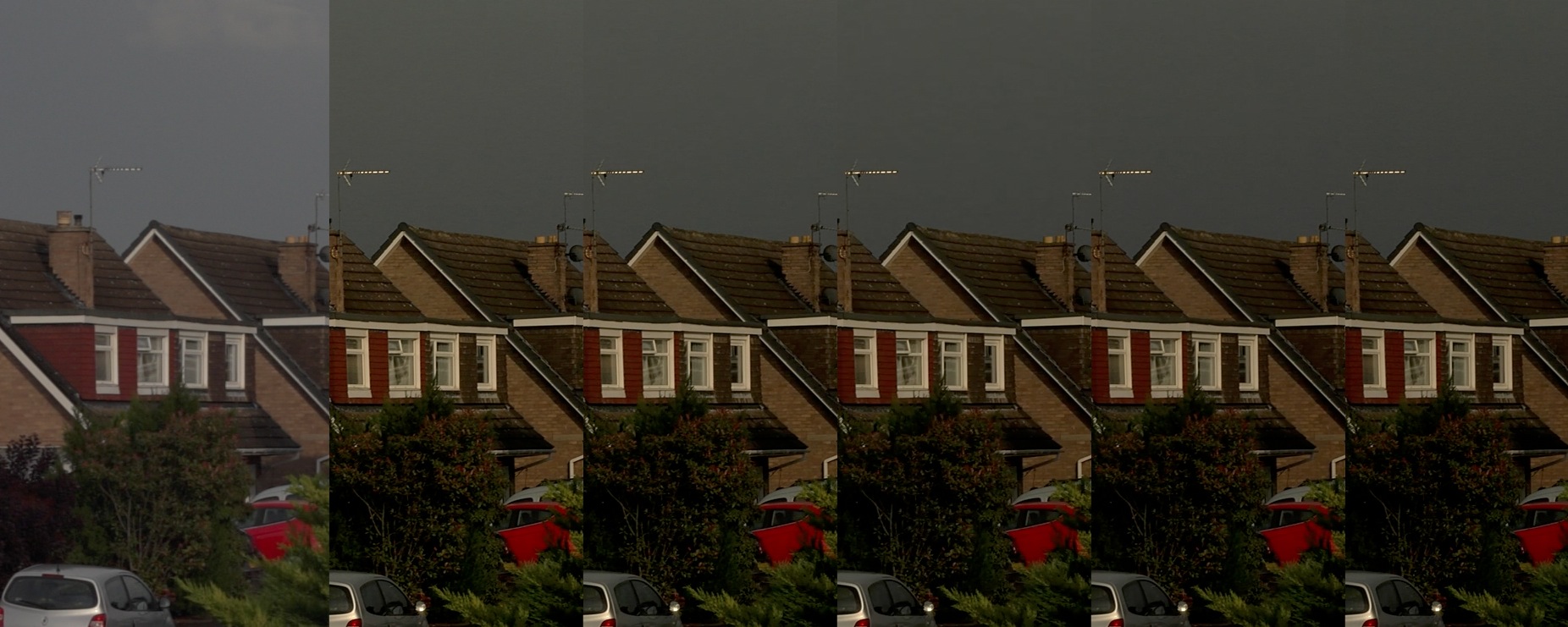

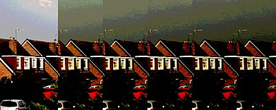

The macro blocking it's a tricky thing to show, but I've attached a composite image of a series of sequential stills as I rack the iris down on the JVC.
You might expect some banding in an 8 bit codec, so I put the same lens on my FS100 and included an FS100 image on the far left. The JVC is much sharper than the Sony, but the noise pattern on the Sony is much better.
I've pushed the image around in photoshop to accentuate the blocking.
It wouldn't be a problem except for the fact that the rest image is very clean and your eye gets drawn to these errors as soon as they occur. I guess an external recorded would have this problem, but that's not why I bought this camera.
