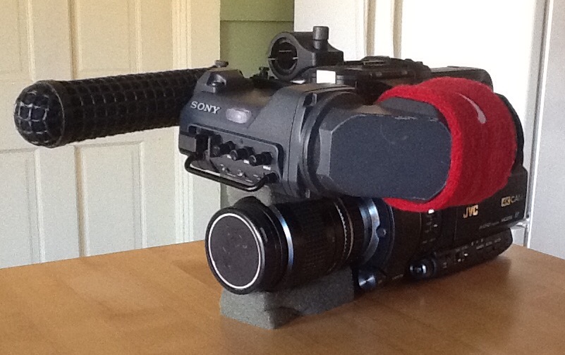

...I'd like to have my old B&W viewfinder working on this (my friends) LS300. Tried shooting outside yesterday and it was not a pleasant experience, to say the least. I've had this idea to mod up my old Sony Betacam viewfinder for some time so that I could use it on cameras I may rent. I think now is a good time to go ahead with that project.
The camera is outputting standard def video from the AV jack all the time. They are using a 4-pole 3.5mm plug kind of like what is found on the iPhone. I should be able to make up a mount that slides into the shoe atop the handle. Power for the VF can come from a small external battery perhaps added to the bottom via the 1/4 x 20 tripod mount socket.

I have that same viewfinder in a drawer somewhere, hated it then, would hate it even more now... For around 600 bucks you can get a Z-Finder Pro EVF - it's lighter, much smaller, self-powered, sharper, color or B&W, has zebras, it's own peaking and 1:1 focusing aids and it's HDMI...
I'm a DIY guy, so I understand the compulsion to do this kind of thing, but I'd put the effort elsewhere.

There were different versions of this viewfinder. The one that came on my camera did not have peaking and was not all that sharp. This was one for another model Sony that I was able to buy as NOS. It has an internal peaking circuit and better contrast than the first.
It may work and it may not. If not I'm out the cost of the 20-pin socket. I like a challenge and I like to save $$ when I can.

Which is why using an old CCD camera viewfinder would make sense. Easy enough to make a mount to slide right into the hot shoe of the handle. The LCD is still available for checking color, system specs etc. For shooting and focusing outside in bright sunlight the extra VW would be a welcome addition.
