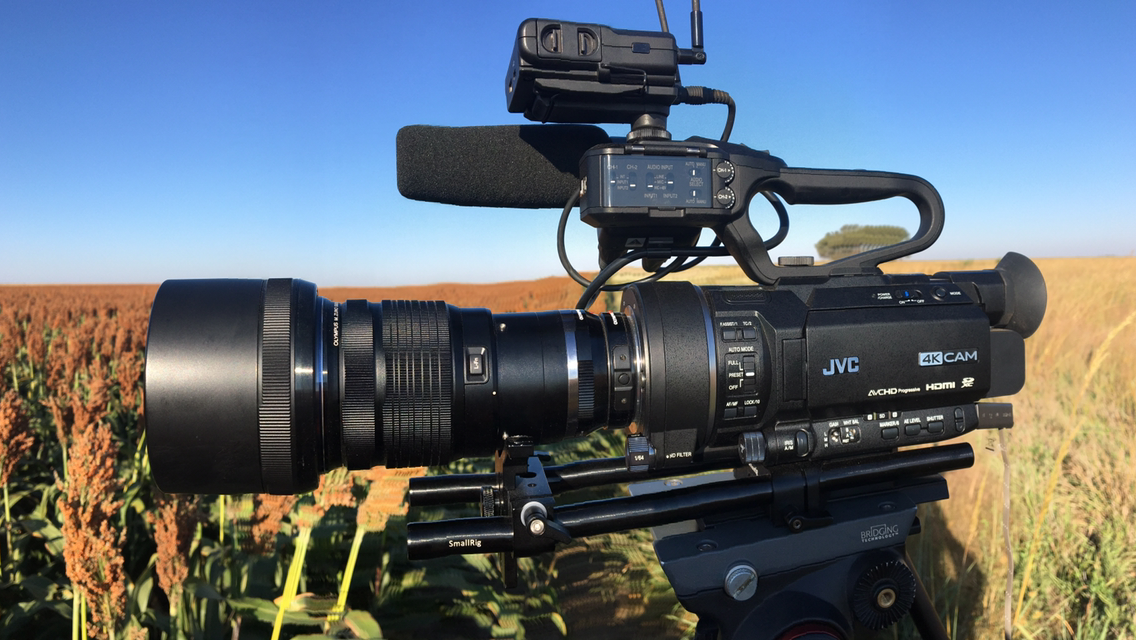

We 're using this SmallRig plate and rods with a lens support up front. The lens in the pic is an Olympus 40-150mm f2.8 with the 1.4x tele converter. Very stable lens support. We've also used the same setup with a big Canon L 100-400mm - worked excellent.
