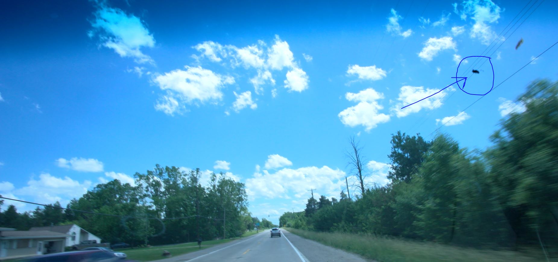

The sensor module is said to be sealed and you can not open the sensor module once you remove it for the camera. So you can not get to the sensor because the protective glass is the top part and the sensor is the bottom and they are manufacturer sealed together. the tech said that they must have used an epoxy or something similar.

Re: Sensor Has Dirt In The Module
Since the problem is foreign objects getting inside the "sealed" sensor stack I would think JVC would be very interested. Sounds very much like a manufacturing defect. Possibly they will give you a courtesy repair.

Did you not see this right after you got the camera? Those are some very obvious dirt spots, it's hard not to see them.

Not right away. I will say this though, it was there while shooting part of my music video. So I believe that it came from what ever part of the module itself half way through my shoot. I checked the footage before and it was not there. When i get to the car scene I noticed it. The next day after shooting it was there and after messing around with it it has disappeared again but now you can see a spot where it was. So to answer you question, no I did not see it at first.

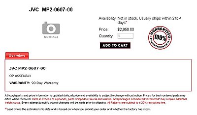

Ok, so I sent my LS3 in to JVC and just got it back today. It turns out that they had to replace the sensor assembly. The cost was $2950. Thank God for warranty repair. I have attached the part listing that I found online.
PacParts: JVC MP2-0607-00

Aaron - It's good that it got fixed without having to pay for the part.

However, It'd sure be nice to know what this "thing" was, where it came from, and how it got in there.Was it a foreign piece of matter or was it a piece of something, like a piece of foam from something inside, for example. Was the particle in there due to handling (like a bump), manufacture, or via lens changing? Is this something that can be avoided?
Anyway, more details from the repair facility would be helpful.
Edit: one could almost buy a new cam for what the part cost (if you had to buy the part).

I will give them a call in the morning when they open and inquire. It would have had to be a piece of something from with in. I know this because when I sent it out to a local repair center they told me that the sensor module could not be opened that it is manufacture sealed. When I sent it to JVC they put in another sensor module. This tells me that the object could not have come from outside the module but inside. I will call in the morning and get more information.

What a ridiculous estimate that is, and they are actually going to replace the sensor? You can get a new ls300 for 2595 now: https://www.bhphotovideo.com/c/produ...eld_s35mm.html so it would have been much easier just to send you a new one and use the old one for parts.
