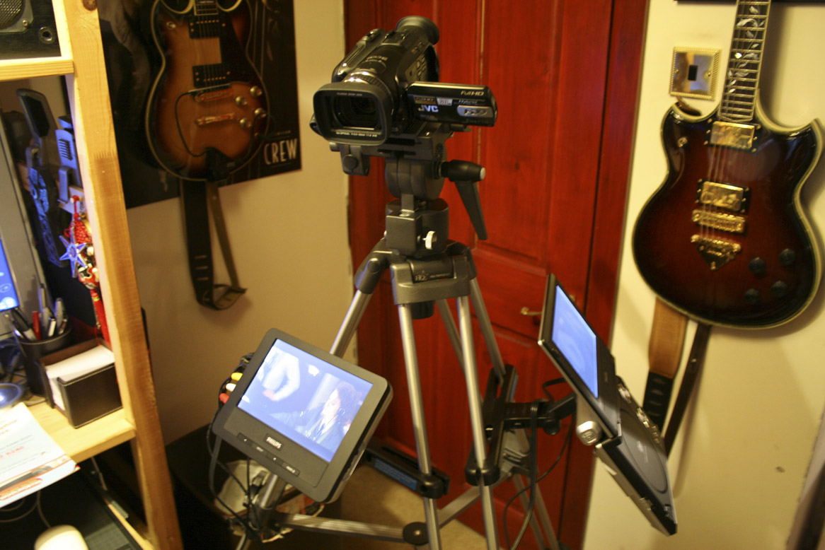

HI Manuel.
I use the same kind of thing. I have a Philips PET50 (I think that's the number) and it is a portable DVD player and extra 7" screen. I bought a little bracket arrangement from Hague and now the second monitor sits in the hotshoe above the cam and the DVD player clips to its own clamps (Meant for the back of car headrests) which I clamp onto my tripod legs. Power comes from either mains or battery on the DVD player. It's lo res but perfectly good enough for framing shots.
Here's the setup when they were both fixed to the tripod legs before I got the hotshoe set up sorted. The beauty of having two is that one can be viewed by the cameraman and the other by the director. Also, it doubles on headphone outputs, meaning the soundguy can have one as well as the cameraman. The other good thing about the hotshoe bracket is it is on a little ball head arrangement which can move about 360 degrees depending on what angle you might need. You can even flip it completely if you are using a lens adapter.

Hey Wayne !
Very Cool ! I like it, a clean setup. I've never seen a bracket like the one you are using. That actually clamps to a car seat headrest? Just goes to show you, if you look around, you'd be surprised what can be found and used.
You're right about the headphone outputs. They do come in handy. The Sony has 2 headphone outputs which is OK for me. When I don't bring the Sony, the cable I use from the camera AV works well too. I never thought about running 2 monitors off the same camera. I wasn't sure if the signals would get loaded down. I should give it a try!
Do I understand correctly you managed to mount one on the camera shoe? Is it kind of heavy or tipsy? What is the resolution of the Philips you have?
OK! I was going to ask you, how the heck you are able to post thumbnails to your posts? I've been going nuts trying to figure it out. Duh! The only thing I could find was the /IMG command. Now, today as I post this I find an attach file option I've never seen before. Am I going bonkers? OK! Don't answer that!
Hey! The head on that tripod sure looks familiar! !

Hi Guys,
The screen is not particularly hi res, but there's no banding and it's simply useful as a larger screen for easier framing - I wish it was higher resolution, but hey, it was cheap).
Also, I have got the Twoneil lens adapter (which I will be trying out today for the first time) and with the screen attaching to the hotshoe (coldshoe?), I can simply flip the monitor round to get a better impression while filming. (Hopefully)
I usually only use one screen (the one without the DVD player attached) mounted on top of the cam and it's very light so there's no problem with tipping over.
The guitars in the shot are a Yamaha SG2000 and a very rare Ibanez Artist Bob Weir signature model with the 'tree of life' up the fretboard. Both are reissues of the models from the seventies and are in mint condition, SERIOUSLY nice guitars. I'm considering selling both of these and keeping my other two guitars, (an Ibanez Les Paul Recording copy from the early seventies and an Antoria Custom agent) as I don't play as much electric as I used to, and they hang for months at a time without being touched. I'll get them on eBay in the next week or two.

That is an awesome solution. I am just looking for a decent set of sticks to plant the GZ-HD7U on if I decide to get a couple of them. I am borrowing one now, but funds permitting I would like to get me a pair of them.
how do the monitor brackets mount to the legs of the tripod?

Hi Mark
they come in two halves, so you put the front on the 'outside' of the tripod legs and the back on the 'inside' then clamp them together using the supplied long screws. There are four screw holes in each set but I only use two of them, the centre ones. Then in the centre of the brackets is a slot, into which an adjustable arm slots and locks. You can move the end of the adjustable arm to whatever angle you need, but only up or down. All this comes with the Philips set. Takes about five minutes to set up. Hope this helps.
