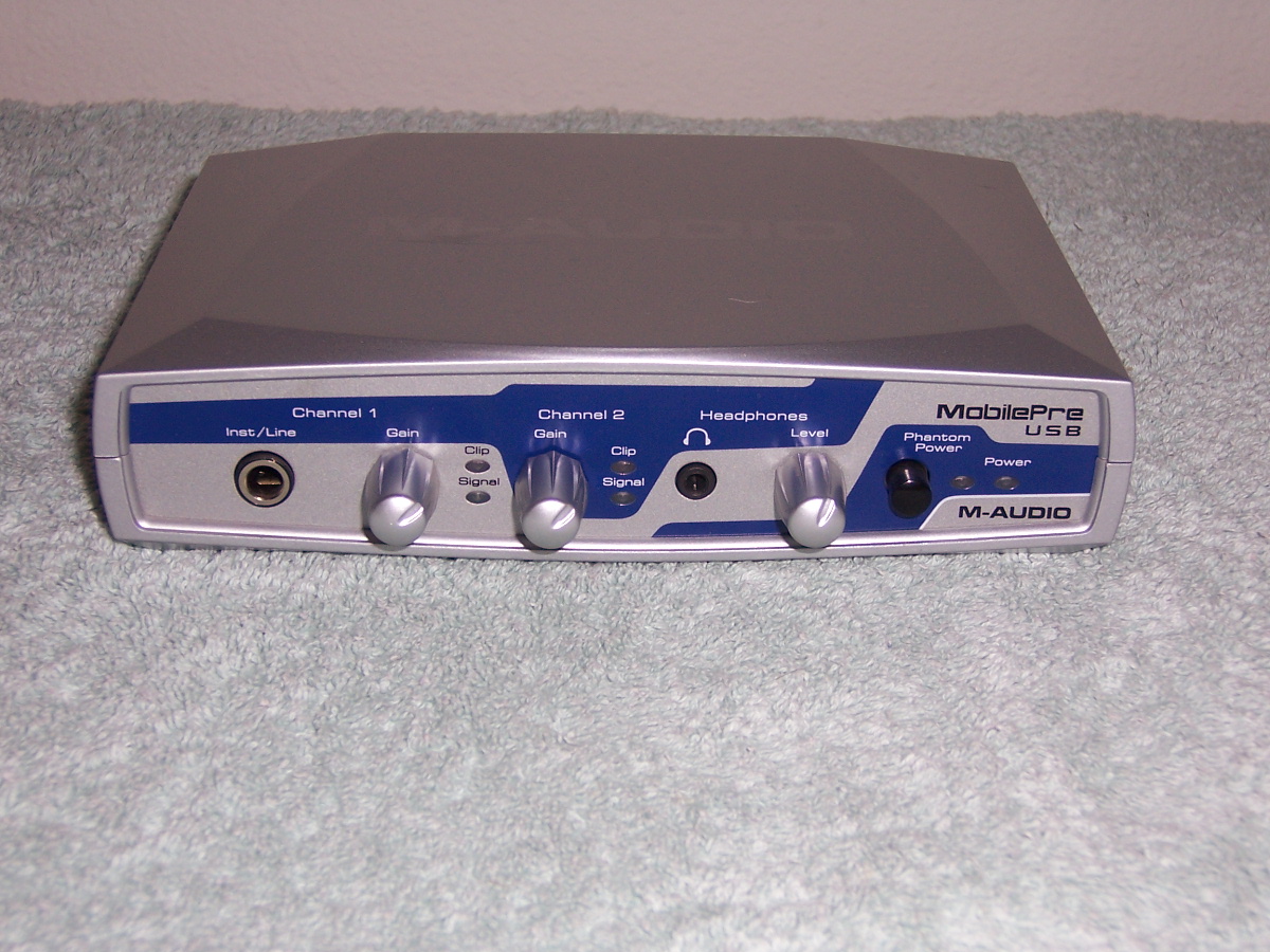

You're a little too late with the comment about buying more stuff. It's already happened! See one of my posts in this section "new to me" that I took last summer. When I got this camera the mic, while pretty good, was picking up too much undesirable noise. I found a Sennheiser shotgun mic that a guy wanted to unload - along with some other stuff - and that's in the picture. A MobilePre with XLR cables, books, etc., also came along with it.
The next thing I had to get was a charger and cables for the HD7 because when I got the camera they weren't included. Then I found a JVC GZ-MS130 video camera which is somewhat newer model but a point-and-shoot type for people to upload to YouTube really cheap. It had the same charger and cables so that worked out. Now I have what you might call a "B-roll camera".

[More for Waldemar:
You're a little too late with the comment about buying more stuff. It's already happened! ]
Acquiring additional equipment is a never-ending task. The challenge is determining what will really serve you well. So far it appears you have made a good start.
Waldemar
