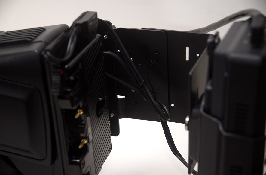

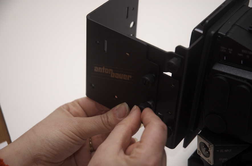

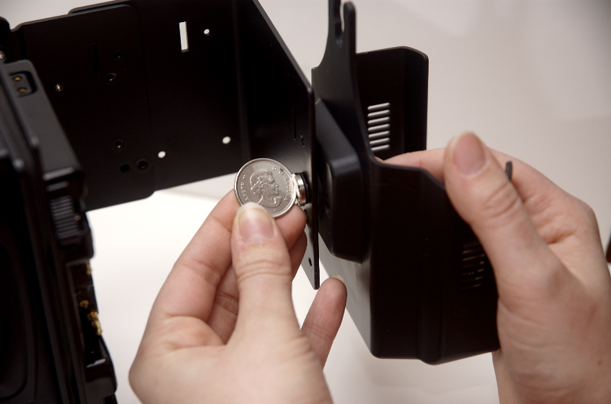

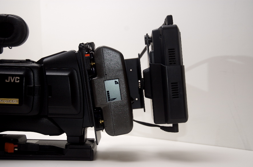

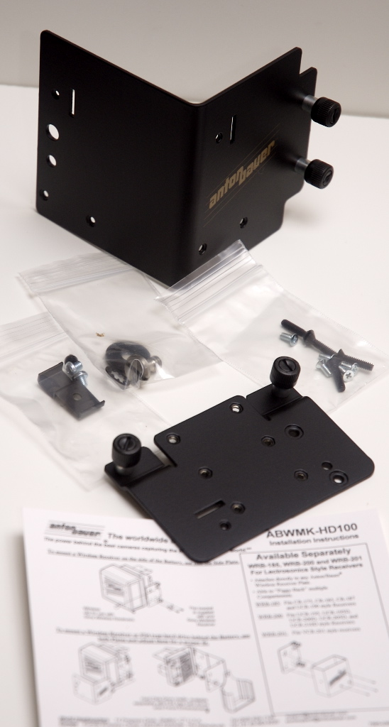

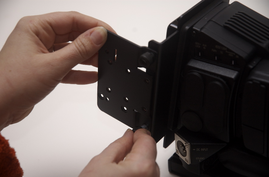

If you have the Anton Bauer mount I have a step-by-step tutorial in the works that I'll publish on the web as soon as I have the time.
In the meantime I've attached some of the photos I've taken for the tutorial.

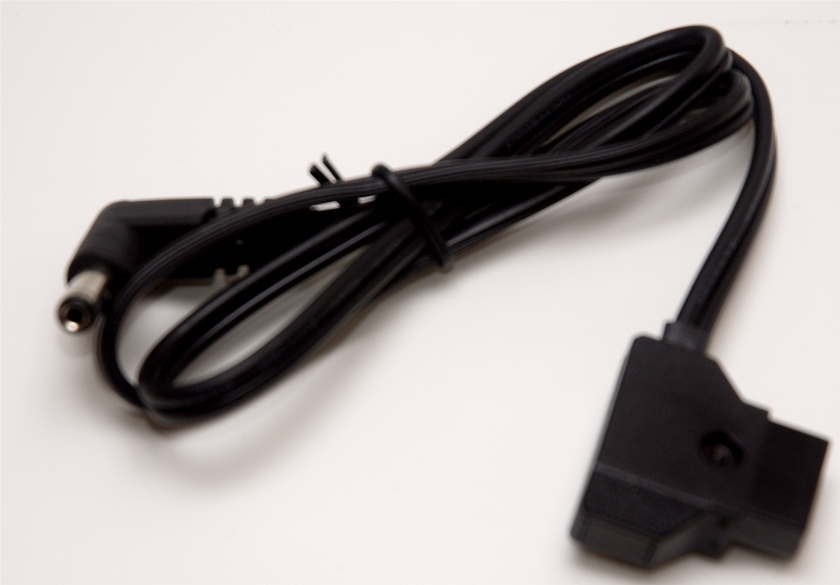

You will need to purchase ABWMK-HD100 Kit from Anton Bauer as well as PowerTap FS4 14" power cable. (pictured below)
Edit: There is apparently a kit called the ABFSKIT1 that includes all of the above.
How are you mounting your FS-4 HD?-_dsc1042.jpg   How are you mounting your FS-4 HD?-_dsc1044.jpg
How are you mounting your FS-4 HD?-_dsc1061.jpg   How are you mounting your FS-4 HD?-_dsc1062.jpg
How are you mounting your FS-4 HD?-_dsc1067.jpg   How are you mounting your FS-4 HD?-_dsc1075.jpg

Great pix Tim, thanks. Alas I'm using an IDX mounting system.
I can't offer any first hand experience then. Sorry. I've played with the JVC demo models that featured the IDX FS-4/DR-HD100 mount, but I have no idea what the model numbers are. I believe there is another thread from about 3 or 4 months ago that did have this info.
