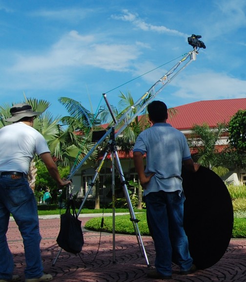

Just wrapped a shoot with the hd100. mounted it on a 12footer DIY crane.
This camera needs 20 pounds of counterweight on my set up.
This camera doesnt have auto focus. It has excellent focus assist. You can capture it even with OHCI firefire card and have no problems. I use edius.
Ted
