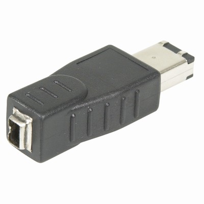

Still a chance for Port Isolators for people in Australia & NZ
I emailed FWDepot yesterday requesting shipping cost to Australia & guess what...? They no longer ship outside the USA.
Every search on Google for any kind of firewire port isolator kept leading me back to FWDepot. In my frustration and short of pulling apart my own FW cables and cutting off the power bus strand, I stumbled upon a 4 to 6 pin converter which essentially does the same thing.
Forget $21! You can get them from Jaycar Electronics for $6.95AUD.
See: http://www.jaycar.com.au/productView...=&SUBCATID=435
JT

Firewire Port Isolator
USBFirewire will ship this port isolator to Australia (or anywhere else I presume).
FireWire Port Isolator - 6pin - 6 inch
They also make some useful right angle cables that change the angle the cable exits the camera to directly back and keeps the cable very close to the camera body for those using the DR HD100.
Phil Balsdon is offline   Reply With Quote

Some good news!
I just got a call back from my local JVC service center, after they had taken a look at my HD100 with the blown HDV firewire port. They initially told me they would have to replace the entire mainboard at a cost of $1800. However, when they took apart my camera they found that they could replace just the firewire chip instead. As a result, the cost for the repair is only $425! Whew!
It seems JVC may have used two different designs for the mainboard in the HD100: one with a firewire chip permanently attached to the circuit board, and one with a more easily removable chip. Fortunately, mine was the latter. The tech told me that they would also replace the 6-pin IEEE-1394 connector with a "beefier" one that JVC has been using in more recent models, which should, hopefully, help prevent the problem from happening again. Even so, from this point on, I am sticking nothing into the firewire port unless it's a 4-pin cable with an adaptor, or with the port isolator (which I just ordered) firmly in place.
So, if you find your camera afflicted with firewire burnout, make sure to take it to a tech first, before giving up on it.
I'll post back here after I get the camera back next week and let you know how it works. So far, I feel like a dodged a bullet.

No one really know if a port issolator will really work or not because no one really knows why they blow. You can ask 3 people and get 3 answers. In theory you should never be able to blow it if it is 4 pin because 4 pins dont have power but they blow. and why does JVC have a 6 pin anyway there not powering anything? I wish JVC would step up and cut us a break I have seen more JVC blown firewire port threads than any other camera clearly JVC had a design flaw and were paying the price.
