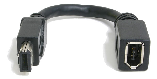

This cable will not send power to the camera.
I think this is a must have for JVC ProHD owners:
http://fwdepot.com/thestore/product_...roducts_id/356
$30 with shipping beats a $1900 repair bill. Call it insurance. JVC should have used the 4pin cable as it comes without power.
tup
Blown Firewire :(-firewireportiso.jpg
tup
I found this 6 pin male to 4 pin female adaptor on Maplin UK at £4.98:
(sorry for long url - hope it works OK)
http://www.maplin.co.uk/Module.aspx?...-PIN%20ADAPTOR
Together with a 4 to 4 or 6 to 4 pin cable (depending on your camera) it should also isolate the bus power.
