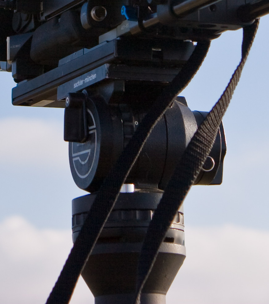

Old December 17th, 2007, 10:57 AM   #20
Location: Palo Alto, California
Posts: 520
Brian, I'm using a Sachtler hotpod with an out-dated fluid head on top that does not boast it's model #. I'll attach a photo of it to this post. For the record the lens is out-dated too - as am I. Old, rules!
I have been expecting somewhat of a horror trying to steady the camera in fluid shots, and in tracking a moving subject, but I have to say it's not really so hard - with this tripod and head. I still need practice but I can tell this might work. Surely this is not the setup to use if you're doing what I'm trying to do because it'll break your back (ironically mine is already broken in three places) on a hike. But it is actually very easy to set up on uneven ground and it steadies the camera quite well (as long as you don't extend the neck too far). Plus, this is the only tripod that I own.
Thanks Brian. The journey continues

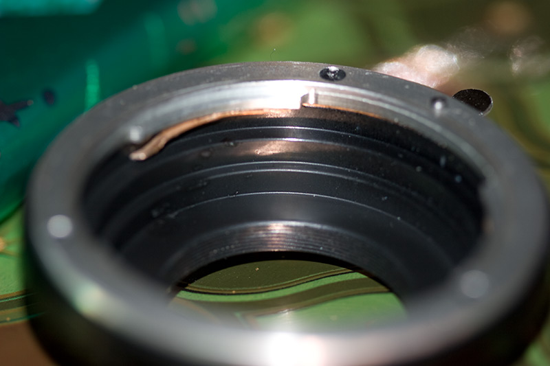

As for downsides of the Zoerk adapter, I am currently still facing only one. There used to be two:
1 - (solved) - Initially the adapter did not fasten any of three Nikon lenses as securely as I had hoped it would. I actually sent Joshua (US contact) links to the posts I have put up here and he inquired about the issue of loose-fit. I had expected that the excessive weight of the 2.8s would stress any adapter ring so when I found play I was not surprised, but still I was a bit disappointed. Joshua asked if I could provide him with images and more detailed feedback, so I made him THIS
In less than five minutes from my sending him this, Joshua had already contacted Zoerk in Germany, and promised me that they would send a new adapter because this one must have been out of spec. He also said that not one user had ever mentioned a loose fit. In a week and a half the new adapter arrived with a note attached, saying this was their latest version made to much tighter tolerances. They weren't kidding either. This new adapter is actually a better/tighter/more solid fit than that of any of my original equipment Canon lens-to-camera mounts. I give it a stand out A+
So if you do order an adapter from Zoerk, Paolo, tell them you want the latest version.
2 - (not solved yet) - The Zoerk adapter is machined from aluminum which is coated with some type of matte black finish. This is fine, but as you will see in my attached image, not all of what you get is finished in matte black. The actual Nikon mounting ring, which quite nicely is replaceable, is raw aluminum. I took this shot of it using a flash, so you could tell how differently the two surfaces reflect light. It is this raw aluminum ring which I both have been told, and do believe, is the source of a reddish flare that shows up sometimes near the bottom of the frame. I'd say it shows up about 10% of the time on average - and only when you are shooting at a certain angle from your light source.
I remember reading on this forum, somewhere (but I can't find the thread), that another Zoerk adapter user solved this issue quite simply. Apparently there exists some matte black "metal dye" which is used in the gun world, that once brushed on completely eliminates this problem. I have been in contact with a gun shop near here and have not yet found this dye. By the way simply coloring the ring with a black magic marker doesn't solve the reflecting problem. I tried that on the original adapter.
