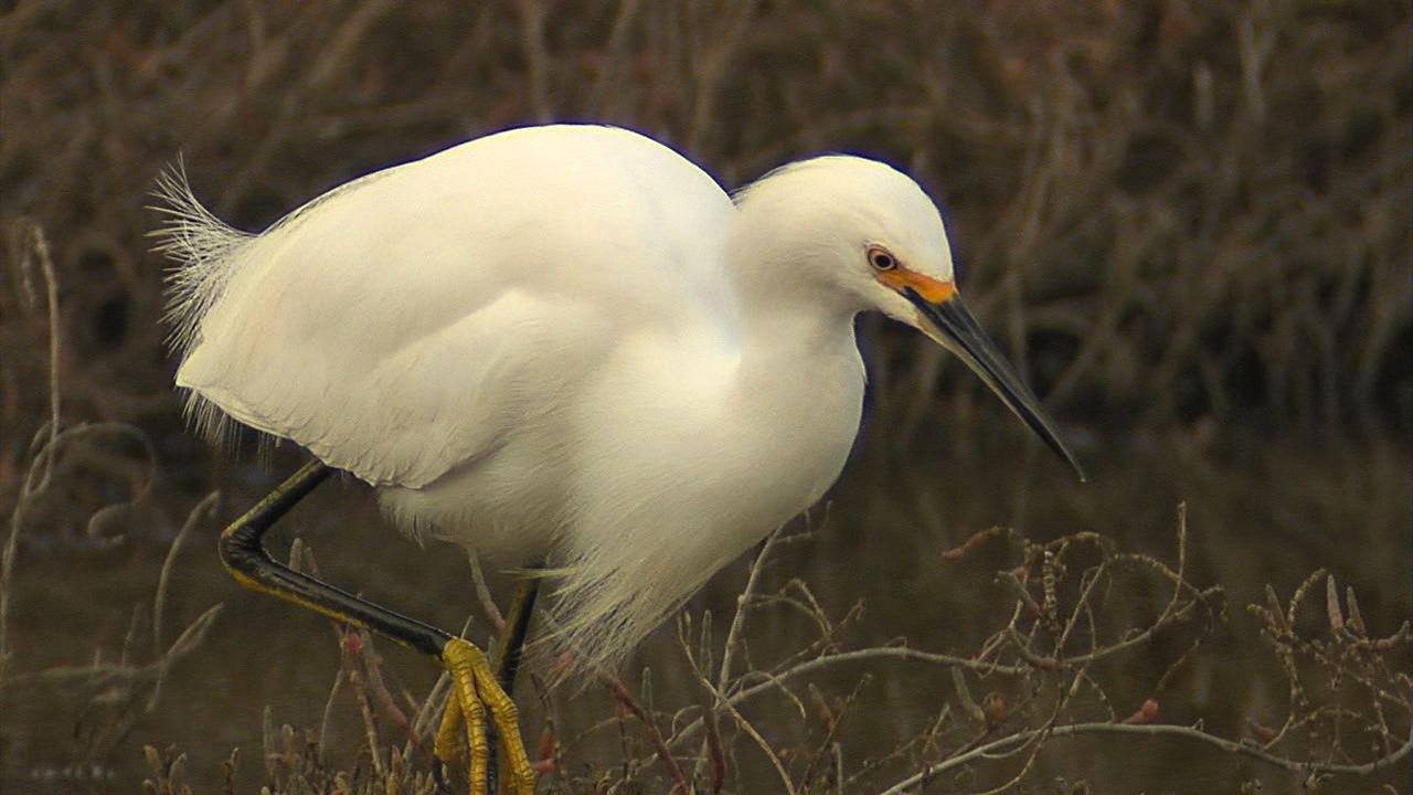

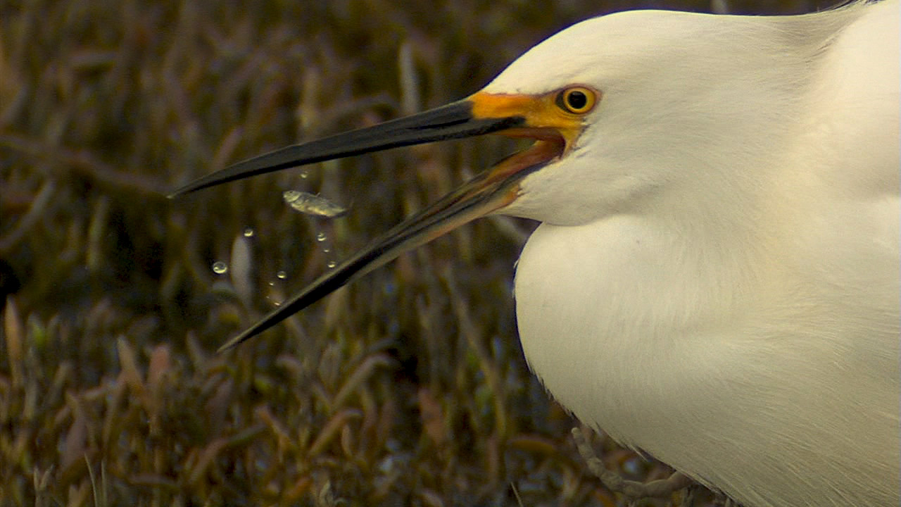

For the love of... zoom
Update, I heard from Mike Tapa that he's been run dry on his adapters. New shipment coming in this week, then he'll send one out. Other than that it's been raining like hell here for days and days so I've shot nothing - except for a quick hour today before the rains came again. Found some egrets and watched them through the 300mm. Couldn't figure out what they were eating exactly, until I checked the footage!
If you look closely you can see the trademark purple haze around the high contrasty edges of the egret on the right and the background. Being that every lens I have put on this HD200 gets that fringe in extreme conditions (whites on blacks, or darks), I am growing suspicious that perhaps this is not a lens situation at all. I think it's the camera.
Anyone care to share some knowledge on this?
FYI the guy on the right is worse because he was shot a bit overexposed. I took that shot down a bit in post, but included it here to show the struggle. Typically I'd try to shoot these troublesome snow white guys underexposed, then bring them up in post - which I did to the fisher king. Works out much better this way. As you can see the two shots look just about exactly the same in the end, only the one shot overexposed is pretty well screwed as far as the purple fringe.
Oh and good lord I thought I had ugly feet?

Still great shots Eric. I think you are well within acceptable technical specs for real world footage like this. Video has it's limitations, and I'd be very curious to see another camera perform better anywhere near this price range.
I might have missed it, but have you tried calibrating the HD-200's white shading for you nikons (and confirmed preset with your 16x)? It could factor in to something like this - I won't say likely, but possibly ;^).
There's a 3rd party fcp filter that detects and masks CA (by selectively de-saturating hi-contrast edges I believe). I haven't tried it, but I can look for it if you're interested. Processing footage is an extra hit of time, and can potentially degrade the footage, but some existing light conditions will stress the limits of any optics and camera. Even film and exotic glass can be pushed to it's limits. What we can do is learn how to extend the limitations, and know the range for acceptable results.
BTW - acceptable is a moving target. If the content is amazing, acceptable can be pushed quite far - if the content is mediocre, well....

As of yet I have never used a plug-in filter for anything. When I was at Paolo's he mentioned plug-ins too. I don't even know where to look, but I'll start now.
