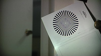

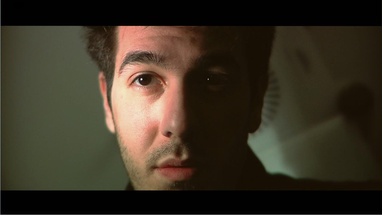

Our Letus Extreme arrived today, and there was a few issues to be worked out, but this is a screen grab, of a test with a subject in a dark room. The light was a 75w pin light. The HD110 was set to True Color v3 but with the detail set to normal.
The color was done in post, added brown to the low levels and added some contrast and brightness.
the picture is slightly compressed via jpeg, but you get the overall look of what I was trying to achieve.
The Extreme is very hard to use with the HD110, only because you have to mount it to the front of the stock lens (until the relay comes out next month). This was problematic due to there being so many lens elements that needed to be adjusted and set just right for everything to be in focus. I will post the sharpness tests and footage on this thread when they are done.

Giuseppe,
Im impressed with the low grain. What mode did you use, 24p?

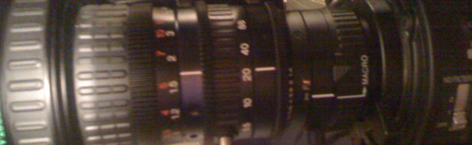

what is the zoom setting on your fujinon, are you at around 30, between 20 and 40 mark?
What is the 35mm lens that you used?

I was on 24p wide open on both the stock lens and the nikon lens.
The zoom settings are as.....
Focus = 5.5 - 5.8
Zoom = 20 (the marker on the end of the zero in 20)
HD110 F Stop = 1.4
Nikon F Stop =1.4
The Lens was an old Nikkor 50mm 1.4

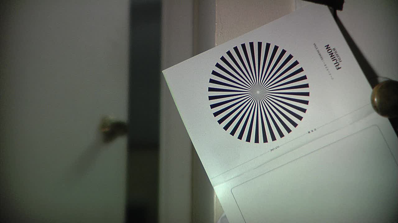

The ground glass is clean, and there is no lube on it as far as I can tell. You should only clean it by using compressed air.
The Letus is precision milled all of the parts have very little give, but I have this to say...
When I did my tests with my 50mm outside, I could not focus to infinity, in fact couldn't focus past 40 yards, it was all soft when the prime was at infinity. I contacted Letus Direct via email, and the next day, they sent me instructions on how to align the GG inside for the proper back focus. After taking the Letus apart, I moved the screen as they said, and that pretty much fixed the problem.
There is also much more to setup on the HD110 than other cameras, because there are more things to set like back focus on the stock lens. This is the part where you will take your fine tuning to focus on the GG.
The quality is very good, on slower lenses you will still notice light loss, I have an odd nikon 28mm 3.3 and its pretty much unusable indoors unless you have 2-3 500w lights going. So all fast lenses are still a must, they are better anyway.
The light loss will most likely get better once they introduce the HD110 Relay for the Letus. This is an add-on relay lens that will attach to the back of your already bought Letus Extreme. This relay will attach directly to the JVC 1/3 mount on the camera body. The stock lens will not be needed anymore in the mix, thus brightening up your shots a little.
I have shot some more test footage and will post it here shortly. Till then heres some more pictures that might be helpful to you...

Looks great Giuseppe! Very sharp, and with a pleasing bokeh. I feel you on that relay. I wonder if it will work with the brevis35...
