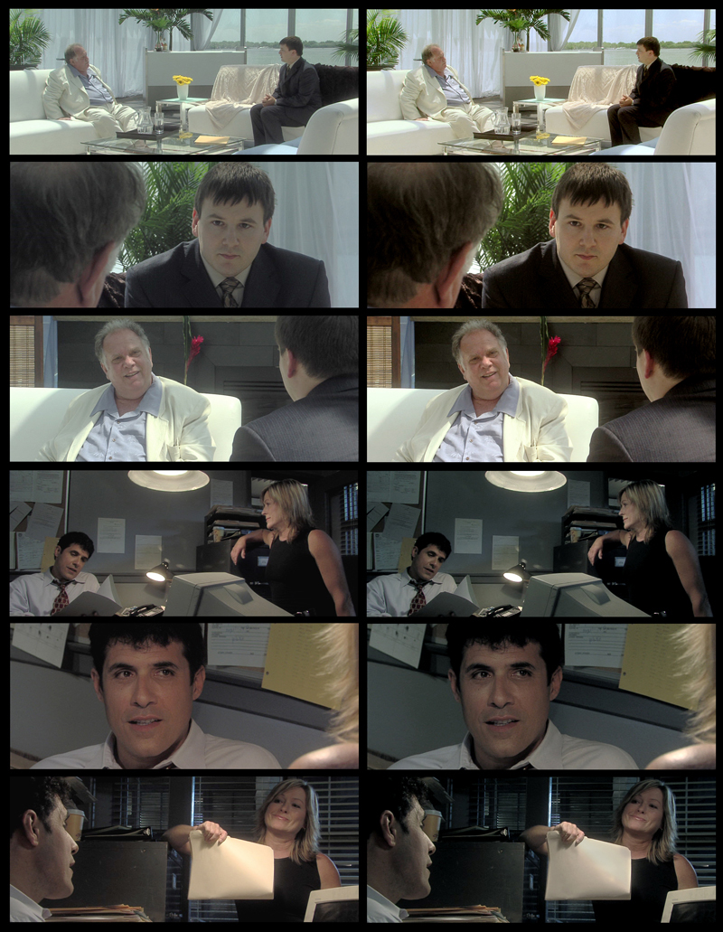

I've attached some before/after samples of the low-contrast in-camera capture (left side) and final color correct (right) using the "Ciné Wide" setting on an HD100. These are from a film I shot called Bull. You can see how the low-contrast image is not very pleasing to the eye, but gives us lots of room to play in post, even with white furniture, white wardrobe and windows.
