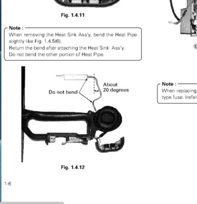

Back on topic: I see from the repair manual for the 111 that the primary heat sink seems to be in the handle. I have to say I've never tried to analyse the heat output from different parts of the camera, so I can't say if that is the only heat sink. But it does suggest that in hot operating conditions, covering the handle would be a bad idea. It might also mean you could get away with putting other protection around the main body of the camera, so long as the handle was not covered.

Robert, the heat sink location is interesting to know, where did you see that?? I'll certainly give that some thought. Mind you, it sounds like the camera can cope OK in high temps. I'll have a look and see if there is any 'official' JVC line on maximum operating temperature. I've read their UK article on sending the camera to Antarctica where it performed without problem...slightly different I know!

The JVC sales brochure for the HD110E/HD111E says the Operating temps are 0 deg C to 40 Deg C; storage -20 to +60. Humidity limits are 30% - 80 % operating, storage 85% max.
I'd guess (from my experience and that of others on this thread) that those are conservative.
Here's a grab from the HD111E repair manual that shows how to detach the heat sink from the handle.
Filming in HOT and dusty climates-heat-sink.tiff
