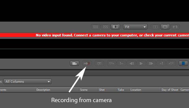

Screenshot
Quick response! Heres a screenshot of my onlocation with the windows that are open :) http://img402.imageshack.us/img402/6148/screenry.jpg

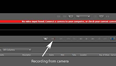

I think you'll find your answer here: Adobe OnLocation CS4 * Controlling recording from Adobe OnLocation or a camera
/Battle Vaughan
Battle Vaughan is offline   Reply With Quote
Old February 6th, 2010, 11:51 PM   #11
Join Date: Dec 2009
Location: Melbourne,Victoria, Australia
Posts: 9
yes
I have tried it with that button on, with no luck, is it maybe because my camera is set to synchro? I dont want to use tapes, is that the best setting to have for that feature?
Ken Grebenare is offline   Reply With Quote
Old February 7th, 2010, 04:25 PM   #12
Location: Miami, FL USA
Posts: 1,505
Here's part of what the help page I linked to in the earlier message says:
Control recording from a camera
If you have a tape or P2 card in your camera, you can start and stop recording with the camera’s controls.
1.In the Field Monitor, click the Remote Control Toggle button .
2.To record clips, start and stop recording using the camera’s controls.
Note: For long recordings that require you to change the tape in the camera, deselect the Remote Control Toggle button. Disabling this option ensures that Adobe OnLocation continues recording when a tape runs out.
It says "if you have a tape", maybe that's it..../BV
