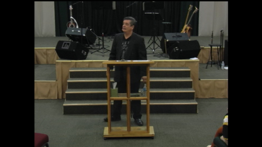

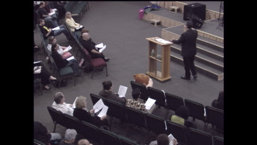

Good Day! I am " fighting" with 2 cameras at our Church. We have a GY-HD100U and a GY-HD110U. I am attaching two pictures. The first is from the GY-HD110U which is set directly in front of the subject. The second is from the GY-HD100U which is to the right and above the subject.
I realize that the overhead compact fluorescent lighting is horrible. However, we are just trying to get the same color and warmth out of both cameras. Please help... :-| What can we adjust to make the images the same?
I am not going to be able to tweak and test things until Friday. However, I will be monitoring this thread... :-)
Thank You In Advance for ANY assistance and ideas!!!
Glenn
PS - We are amateurs but learning at every opportunity!!! :-)))))

is one using a different lens or lens attachment like a WA. This will cause colour shift. so the camera's match on 3200 preset, We have one in 3 cams that no matter is always 200k difference.
Also sometimes you can even fool the cams to get the same white balance by using a different light source and setting that as the manual white balance so they match. Also make sure your using the same colour matrix on both as well.

i'm presuming they're stock factory settings then, to manually white balance, presuming your auto whitebalance is turned off which is a slider switch on the rear left top of the camera, you point at a white source like a sheet of paper or styrofoam and on the front left hand side of the camera is a rubber button which you depress whilst pushing at the white source, this will then manually set the white balance. if the iris is too wide open you'll need to close it down or a error message will show.
If your camera's are good, they should match when you point both at the same white source.
