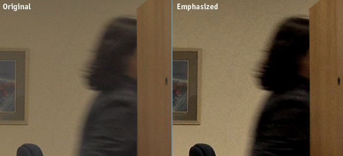

I noticed this in a very rough test shot I did at a client's location while location scouting. Someone walked by in the background and I noticed an "echo" trail follow them as they moved along.
You can see it in this still (1:1 scale, cropped):
http://ethur.stargate.ca/neopics/hd1...ement_echo.jpg
You can see a distinct outline of where the person was in the previous frame. It's quite noticeable during playback (even moreso than the still because it changes between frames), but not overly objectionable. I'm guessing it's due to the MPEG2 compression -- these are probably B or P frames.

I should also add -- my sample is just with the HD100 and stock lens, no Mini35 adapter or similar device.

Here's another link to the file on a different server:
http://www.neopics.com/images/hd100_movement_echo.jpg
If anyone has a problem with either link, it would be greatly appreciated if someone could send me a screen shot of what they see in their browser. I have no problems seeing these at home or at work, so I need something I can show my tech guys.

I do see the echo very slightly, but it's not really bad. It seems more like the grain pattern decided to make an outline of her. I probably wouldn’t have seen it on this still if I wasn’t looking for it. But these small imperfections can get to me in playback if there are enough of them. -just a tiny reminder that you're watching a reproduction of an event and not the event itself (it can take you out of the moment).
