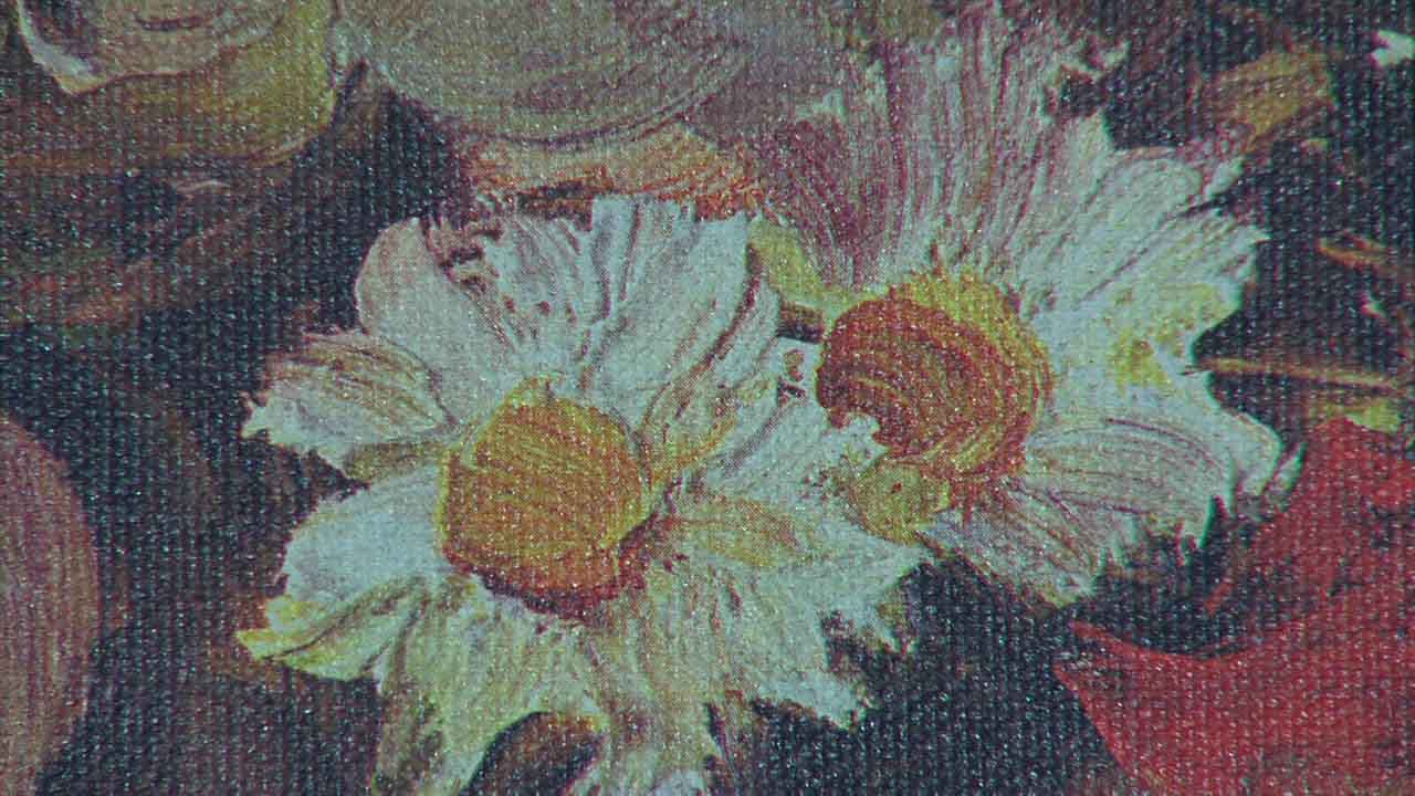

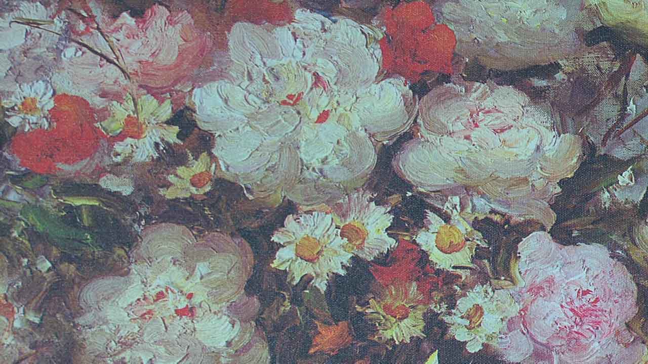

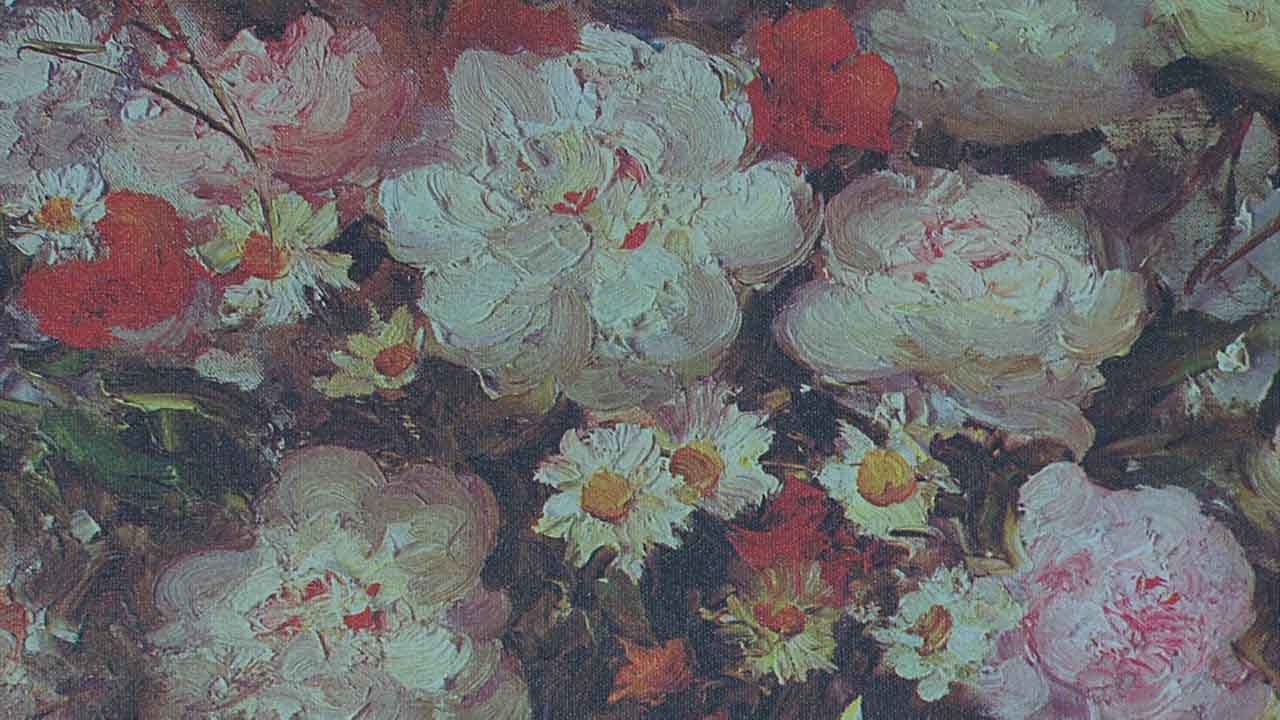

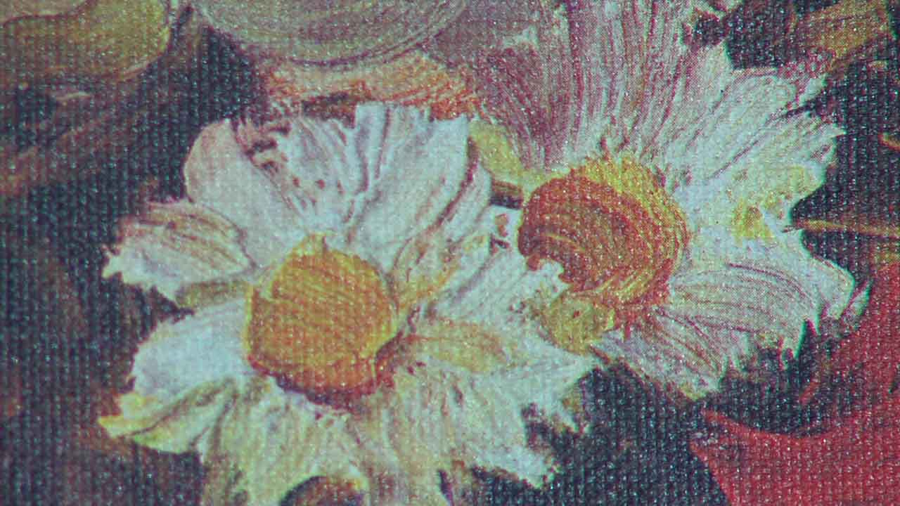

Just discovered my semi retired Pana AJ D200 DVC Pro camcorder is also 1/3 chip camcorder with a Fuji lens T14X5.5BRM4, almost identical to the stock JVC HD 100 lens in all respects except size, its a couple of inches shorter. I swapped lenses and shot some footage. My initial tests show the older fuji is much sharper and a tiny bit wider. Those interested in upgrading the lens might find this interesting.

Are you sure it's sharper? I ask because I know somebody who used to have a D215, which uses the very same lens and I did some tests with the T14 and the HD100 and the stock lens was much sharper. Also as the T14 is an external focus lens breathing was more of a problem than with the stock 16x. I even shot a resolution chart and the stock 16x was the clear winner. I can't re-do the tests because he has since sold the D15 with the lens but I might still have the tape somewhere. I remember this was the same lens Optex adapted for the Xl1. I can't see such a cheap lens as being good enough for HD.

Mike;
My test was short. I need to do some real world shooting with both lenses before I can form a definitive opinion. Check out the stills from both the lenses though. Camera was set to FAW and locked down. For now the T14 will stay on my HD 100. The external focus is not a problem for me. I've put in hundreds of hours on my D 200 which btw is a great camera, with this lens .I will post my future findings here. I look forward to your comments as well as those from others on this board
Jay
PS. Could not upload pics. File size too big. Will upload later.
Fujinon 1/2" lens-jvc-stock-pic-1.jpg   Fujinon 1/2" lens-jvc-stock-pic-2.jpg
Fujinon 1/2" lens-t-14-pic-1.jpg   Fujinon 1/2" lens-t-14-pic-2.jpg

Is that compression from you compressing the still image for the web or from the origonal HDV compression? It is very bad.

compressed to death. original 2.8 MB. downsized to 127 kb.

Jay could you post them as .png files?
they will be very small but look like the originals.
I've got an opportunity to buy one of these lenses and the boss says ok as long as its equal or better than the stock lens.

You should do some tests of your own before you buy, especially since your requirements are for telecine work. I could email the full res BMP files to you if you like. I will be using the HD 100 with the T14 SD lens for the next couple of weeks and will have a better idea if in fact it is better than the stock lens. I can't say Ive noticed the fringing you mentioned in your other post.
