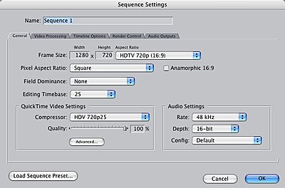

Old October 5th, 2006, 05:52 PM   #4
Location: Toronto, ON, Canada
Posts: 3,637
Andy,
Try this.
Select your sequence and then select "settings" from the sequence menu (or hit COMMAND + 0)
Confirm that your settings are the same as the screen grab below.
Tim Dashwood
Old October 5th, 2006, 06:06 PM   #5
Location: Lanark,Scotland
Posts: 736
here are my settings;
system settings . pulldown 2:3:2:3
sequence pre- HDV720p25
capture pre- HDV
device con- HDV firewire 25fps
video playback- none
audio- default
summery:
sequence preset- HDV720p25
capture preset -HDV
sequence settings:
frame size - 960 x 720 (i tried various settings here, maybe the problem...what should it be?)
pixel aspect ratio- HD 960x720
quicktime video settings- compression- HDVp25
I basically set every setting i could find to 25p HDV, the only thing im not sure about is what pixel aspect ratio i should be using.

Old October 5th, 2006, 06:17 PM   #7
Posts: 736
Tim, you know your stuff.....that did the trick , it was the aspect ratio
a big thank you from Scotland.
you can stick a fork in this thread and call it done!
Cheers Andy.
