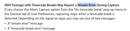

I did a search of the "late breaking news" document and found this.
This suggests that a TC break may be reported as a stream error.
So my next question is... what setting was your TC switch set to when you shot the tape? It should have been set to REGEN to do the type of continuous capture you want to do.
If you have recorded with FREE RUN or REC, then you will have to log your clips and just make sure your inpoints are about 6 seconds after the break and your out points are a couple seconds before the break. You should then be able to batch capture without problems.
